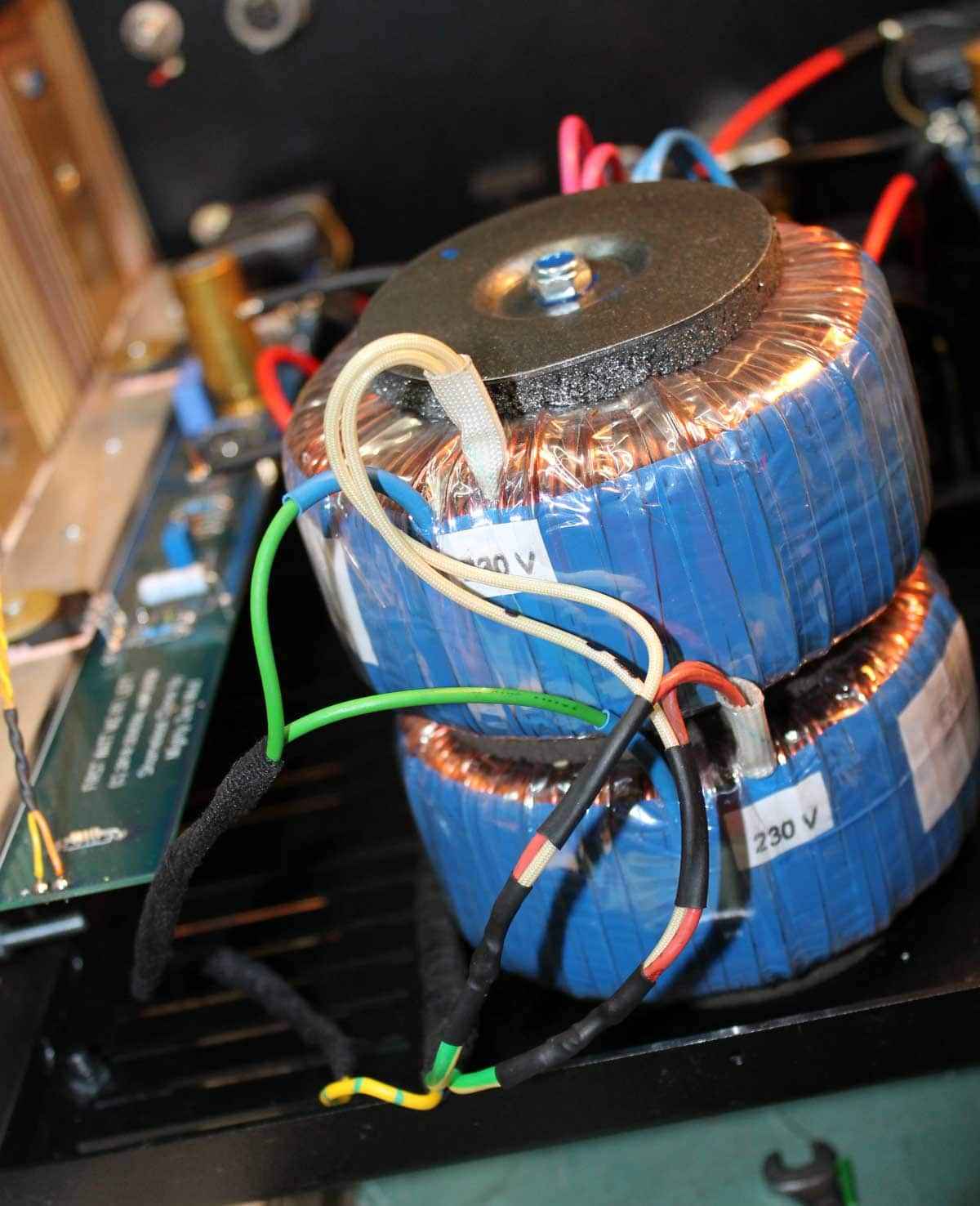

I bought an Antek AN-4218 for my F5 a while ago and after building and rebuilding my amp I finally got it how I want it. I just have one problem, the transformer developed a mechanical buzz. I can't feel the buzz in the transformer but I can hear it. I have the amp biased at .61 and temps are in acceptable range. There are no other problems with the amp and I am very happy with the sound. Is there anything I can do about this or do I just need to order another one? Is 400VA to small?
It looks as if it's allready there... How about reversing the polarity of one of the toroids?

I have rubber underneath the torroid and under the mounting plate. The buzz if faint but I can hear it because it resonates in the enclosure.
No dimable lights on this circuit but I could try connecting it to another outlet and see what happens.

if case is resonating , you need softer mounting
look at picture I posted
Thanks Zen, it is the hollow space that is resonating, not the case itself. I will try a softer mounting before I do anything else.
