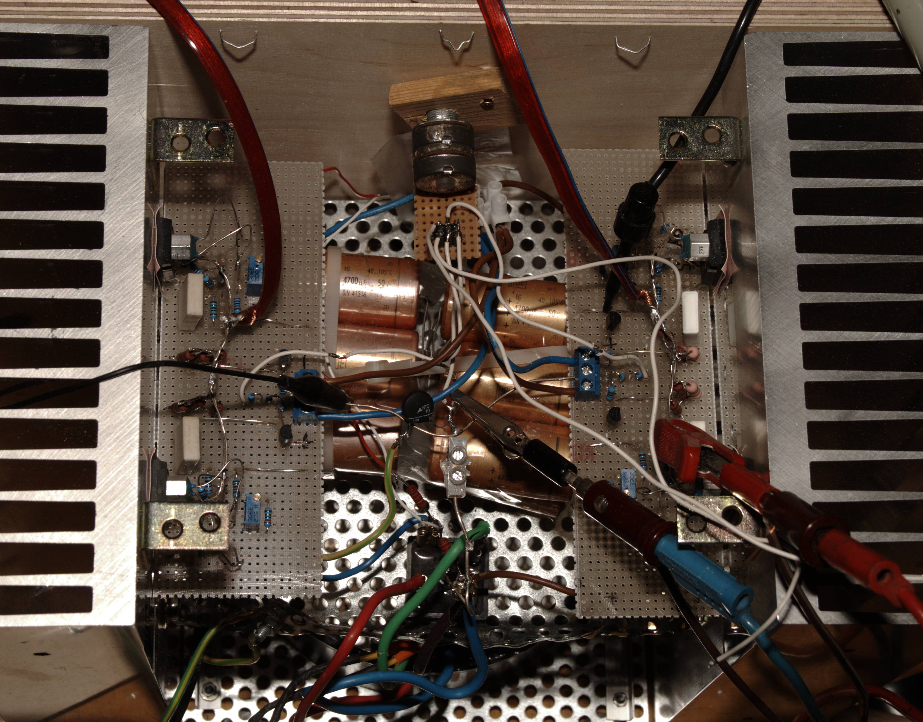

... 0.47 ohm resistors began to glow ...
So I measured everything. The resistors still have the desired value as far as I can tell.
imo ... I would replace it after that
That is a very interesting build, but a bit scrambled to see what's happening. Can I suggest you back out and better organize the wiring. You may discover the problem during that process. There is always the rule of thumb - separate signal from power as best you can.

If the hum is new, Andrew has pointed out a likely source - damaged filter capacitors.
There's also the possibility that your grounding scheme is at fault.

In the yellow rectangle you see the center cables of the transformer connected to ground, obscuring the rectifier below ...
You also see 2 resistors leading to the power LED

Good suggestion is to take out all wiring in power supply and to signal boards. Start again. Easy to make wiring mistake and tough to find when you test everything at the end. Try to route wires in a bundle, use non-metalic bag ties or tie wraps when completed.
It doesn't take much to blow up a high current amp, especially with point to point wiring.

Wish I could see something but I can't. It's been my experience that while focused on fixing one area the physical activity may force a break (cold solder joint etc.) or short elsewhere. If it were my project I'd pull back to the individual sections and add them back in one at a time.

It's my understanding that 'most' hum problems turn out to be ground related.
