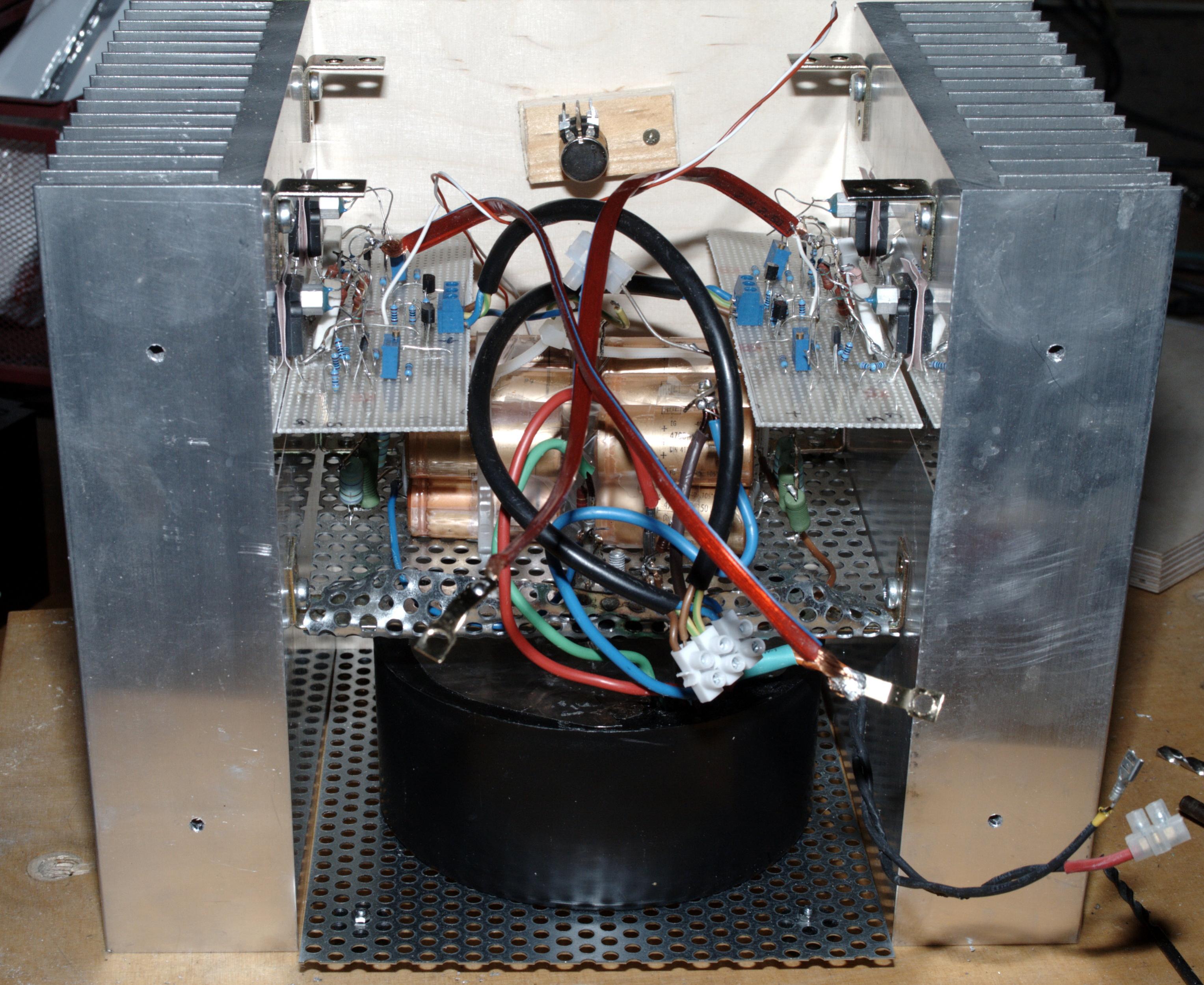

Problem: I have connected the supply inversely (+ at - and - at +). It ran for 3 seconds, then the 0.47 ohm resistors began to glow ...
So I measured everything. The resistors still have the desired value as far as I can tell. The only burned part seemed to be the ZTX550 on one channel, which I replaced and it runs again and sounds well. 😱
But I now have a little hum on the speakers. I wonder if that's from building a case or if there was more damage.
Any suggestions what else could probably be wrong? Any small defect in a part that now makes it hum?
If it's not a defect, how could building the case make it hum?
I was afraid of this ...
(Not everything connected on the picture,
earth is now connected for example, but no change)
