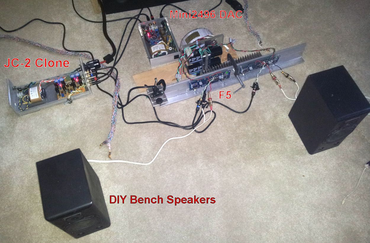

The F5 test rig build sounds great with the addition of a preamp. I used a JC-2 clone built from an ebay kit that has a tendency to slightly sweeten anything it pushes without adding any distortion. I have a Carver C-1 to try but I don't think it will perform any better.
Bias at 0.59V and DC offset at 0.0-1 are stable with ~ 12 hours of use. Not sure about burn-in on an amp without caps but it seems to sound a little warmer with use.
Next step - the box.

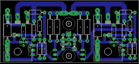

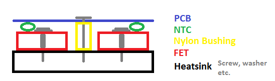

Got 2 F5 amplifiers running now. one with a shared toroid in a Hifi2000 case, very neat and tidy and that one has been sold. Another one for myself with dual E-core built on de back of an old JBL 6290 heatsink including transformers. Used my own PCB design because i thought it could be smaller (this is 76x34mm) and only needed one layer. Dual layer is too much for such a simple design. Keeping traces short (enough) helps a lot.
The NTCs and FETS are on underside of the PCB, rest is on top.
The 2 holes in the middle are there to hold the PCB tightly down, pressing the NTCs to the FETs. By using nylon bushes around these screws as spacers the same thickness as the NTCs+FETS together I get the best thermal coupling without bending the PCB.
