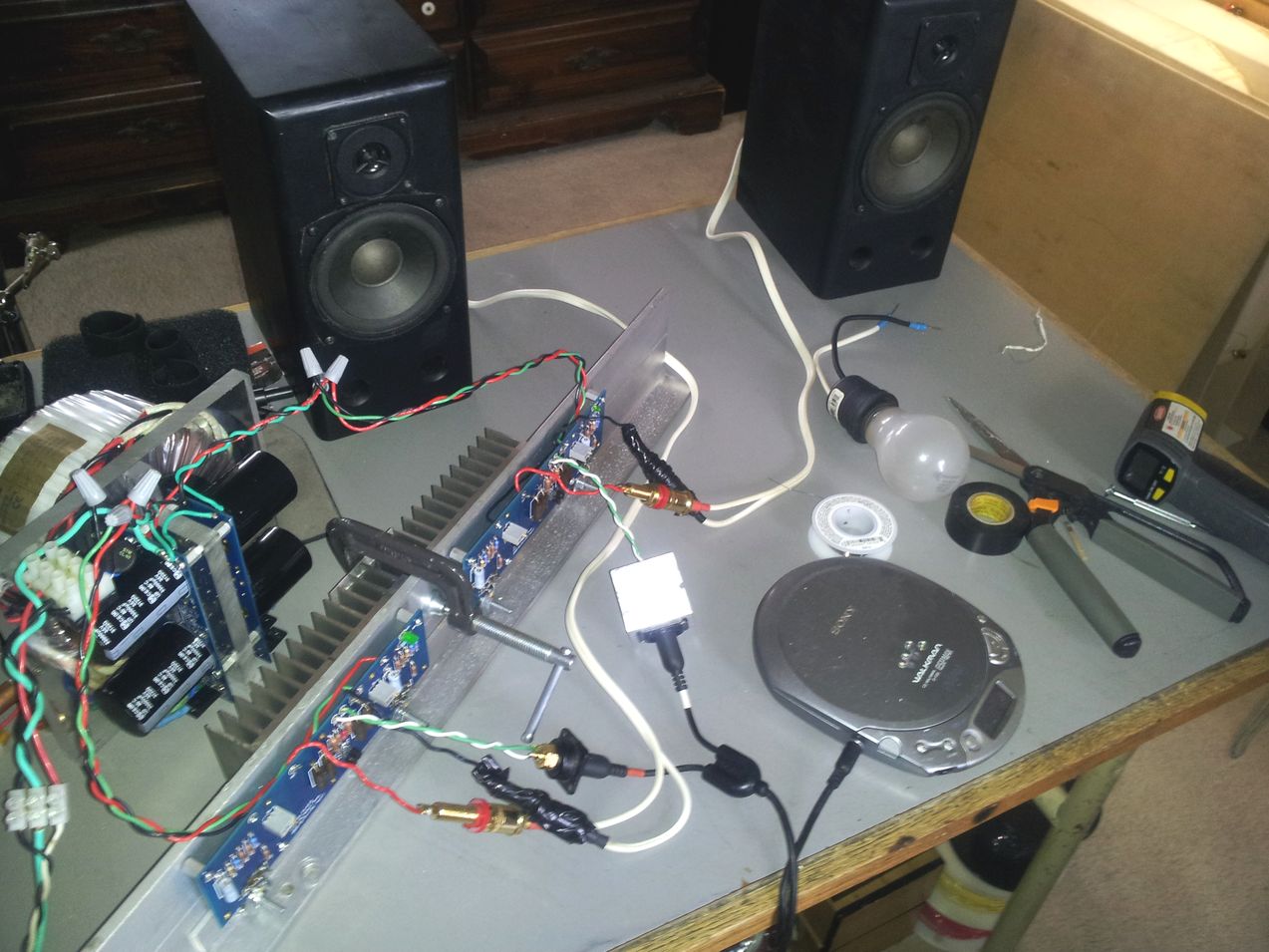

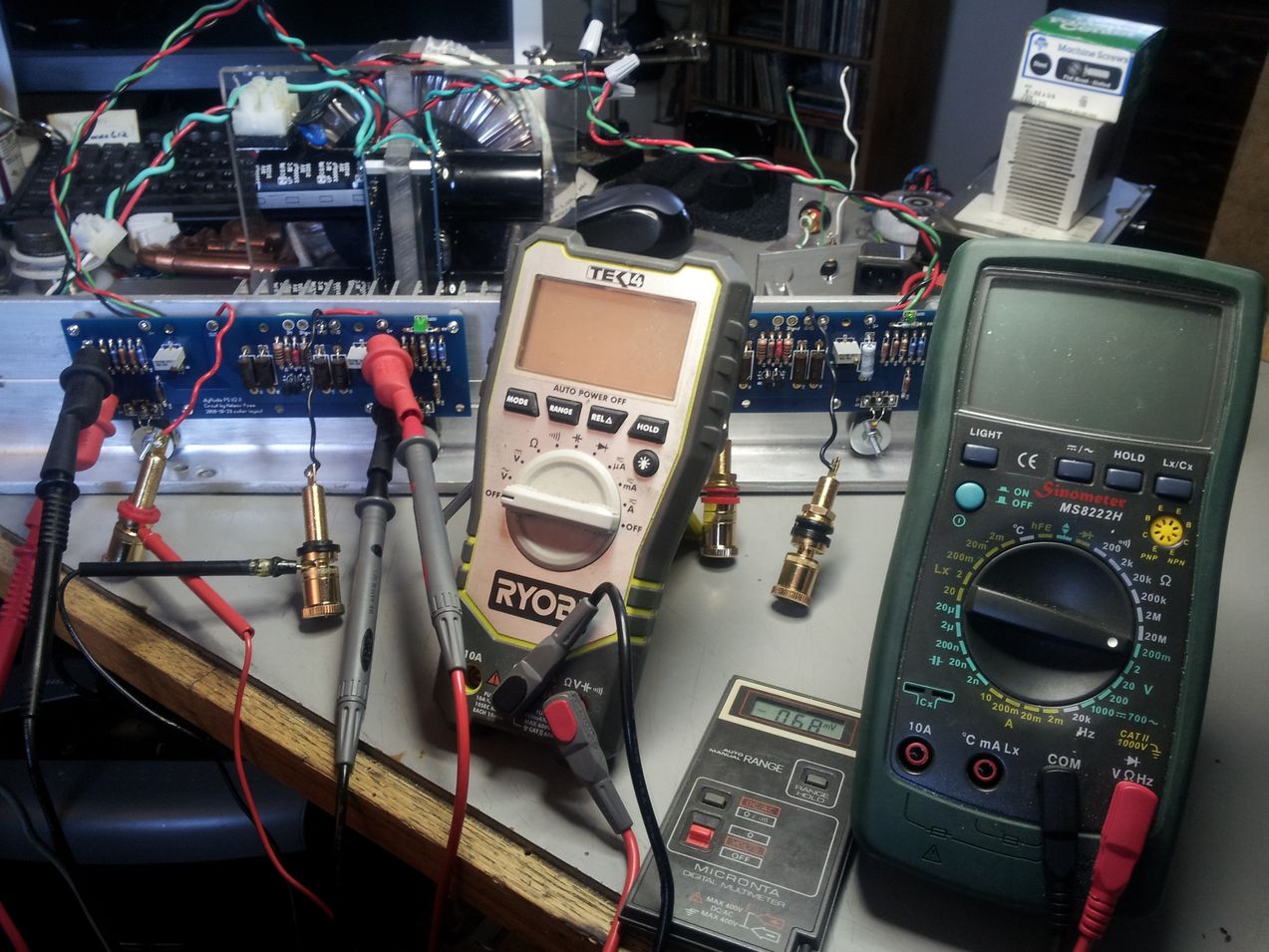

I'm doing my first F5 biasing run on a test rig. Have the bulb tester which is off when everything (3 DIMs) read 0 mV. The bulb starts to glow and gets brighter as I increase bias. Is that normal? (Sorry if that was covered elsewhere in the thread)
Also, Does anyone have a voltage map that can be used to confirm various points on the board?
I learned this with my F5. It is normal for the bulb to get brighter but do set the bias with the bulb tester. Set bias with normal power cord. Bulb tester is for initial power on to make sure nothing smokes. Setting bias with bulb tester and then removing bulb tester will cause it to smoke as the bias is set much higher because of the added resistance of the bulb tester. From experience..🙂
Thanks, That was in the back of my mind but needed confirmation. I'll proceed with a regular cord.

Thanks guys. Were're up and running at .4 V. I'll finish to 5.9 in a bit. Sound is clean, clear and no trace of hum or distortion. (Al Jarreau, Canadian Brass and Sunday In Park w/George so far)
Now to trim and pack it into the latest version of a special DIY chassis.
Big thanks to 6L6 (and Daniel H.) for some major hand-holding to understand signal and power conventions.
I find that the bias voltage tends to rise once the case is all buttoned up. I'd set it to 5.7 or so, then check it after running closed up for an hour.

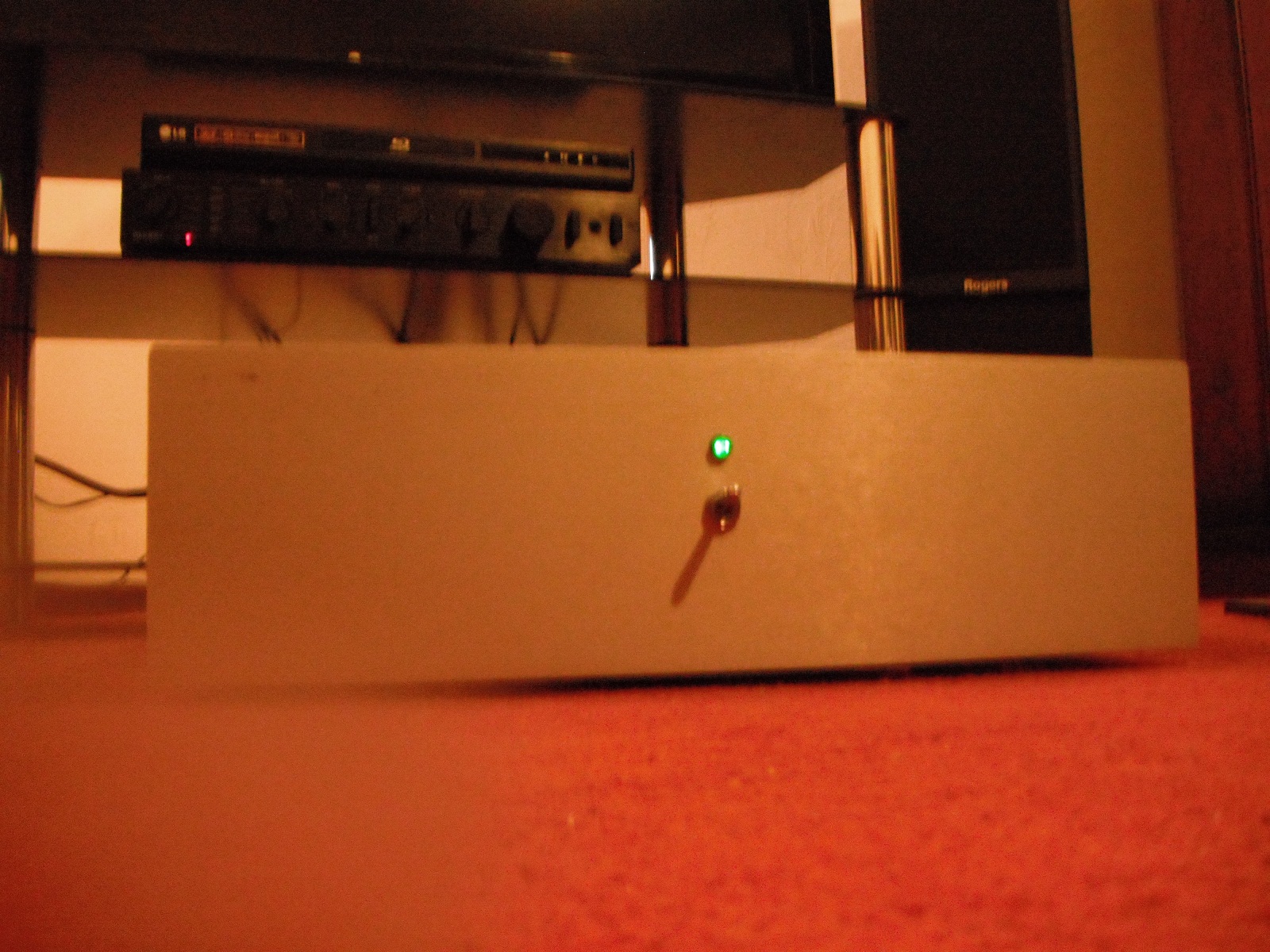

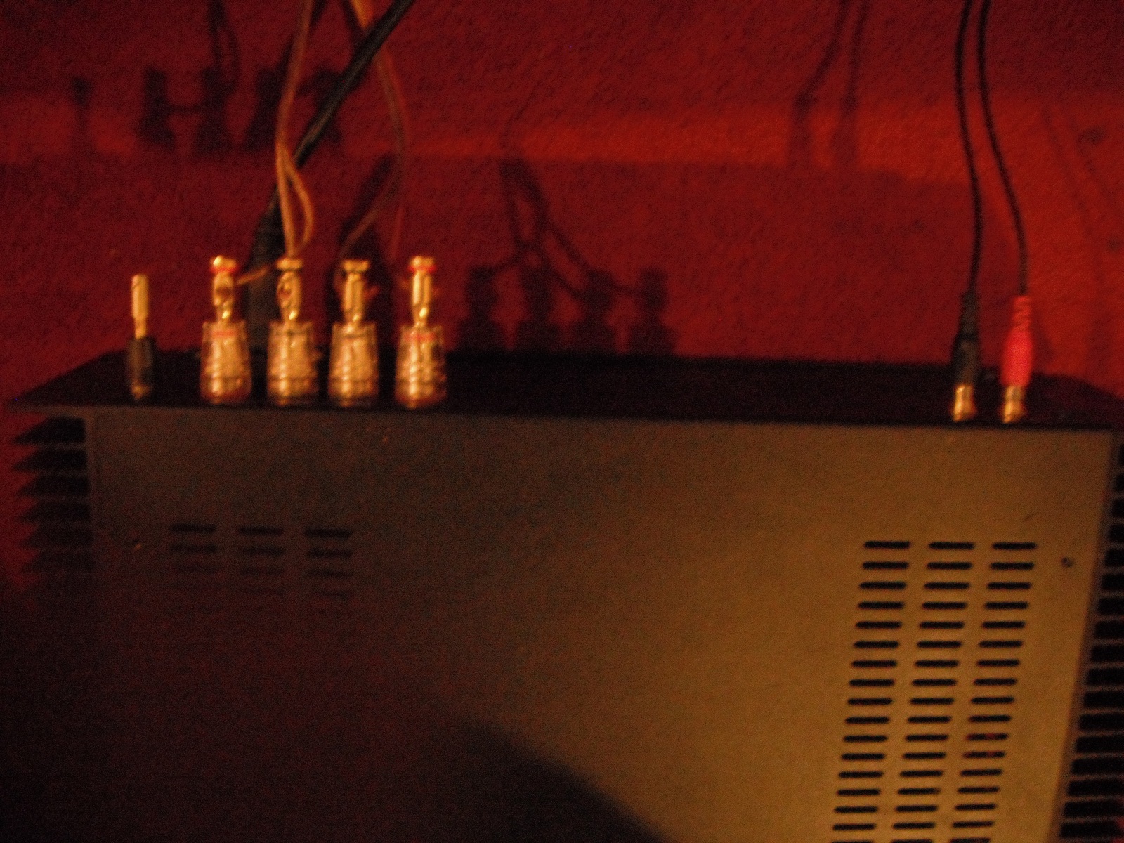

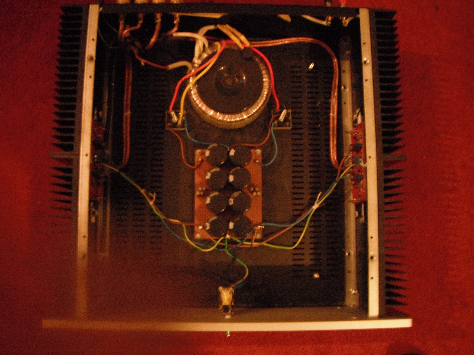

couple more pics of my first F5 Build which was for friend but i was sure i could build it well and well its lasted over 7 months now with no problems, he even left it on for 3 days permanently.
I did under bias but only slightly, i expect its atleast 90% of full bias
It lives at my friends house at the moment but will get it back one day.
Lucky he has Rogers speakers! and audiolab pre-amp which he says sounds nice with it
...........and audiolab pre-amp which he says sounds nice with it ]
