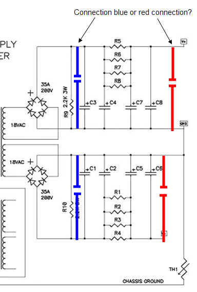

Hi all,
So we can espect a sorter useful livespan for first caps bank , then for second Bank after Resistor, If same time caps are used, due to work harder?
E.g. if we expect a useful lifespan of 8 years in second bank, can we expect about alf time for the first bank?
If so, Reducing the first bank will not worsen this problem?
Carlomar - The life of the capacitors is going to primarily depend on the operating temperature of those caps. Not the rating, but the ambient temperature inside the case. You will get more life out of all the caps, first and second bank if you have many vent holes on the bottom and top of the chassis to promote good airflow in the case. Also keep the amp exterior away from obstructions.
That will help more than capacitor selection.

Thanks 6L6,
I know that, but my question goes in that diretion.
Due to warder work of first caps, it tendency to heat more tham second caps Bank. I am not refering to heat from chassis, but to heat from cap worK.
If we reduce the first caps bank, will it heat even more. I know it depens of the cap type and grade.
I think i remender read some think about caps heating due to poor capacity and hi corrent riple in one F5 tread.

there was one member having this problem, yes
not all know that there are different cap types, also among the Pana
quite many actually
and not all have the experience needed to choose the right type in that cap jungle
even the similar looking snap in caps may vary from 2A to 6A

though, I do have 'small' Rifa 4700uf caps with 30A, at 40 degr temperature 🙂
but 6L6 is right
your box design and layout could make a difference
Use your best capacitors after the R of the rCRC.
Ensure the caps before the R can take the ripple current that will be imposed on them.
Many smaller capacitors usually run cooler than a few big capacitors in this first C position.
Use cheap commercial caps for that first C. They are so far removed from the Audio Signal That comes later that they have virtually no effect on Audio Quality. But they MUST operate as capacitors for the first stage filtering rC to be effective. Fakes and undersized are no good here.
Back to the caps after the R:
These supply the LF current to the amplifier. They should be adequately sized to meet that LF current demand and they should be good for Audio. That does not mean they need to be exotic AudioPhool types, but they must be good capacitors that can release charge when demanded.
These 10 caps are original, not fakes are Vishay BC 15.000uF.
Both caps have left over the bank turned on in the 2nd, the F5 was connected any warms two hours, it was more to not stay 2 caps on the shelf.
They were connected as the schema in Red...
