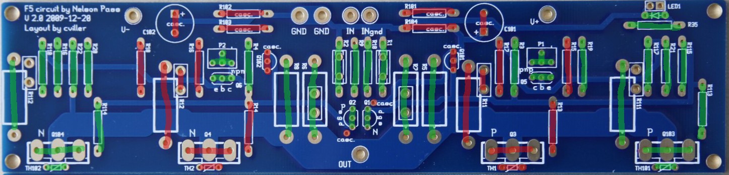

any ideas how to fight F5 Hum problems? I use 1 torroidal trafo (600w), is it possible for him to be the source of AC line humming? I am 100% sure that audio boards, power supplies, grounds are ok.
Would AC line filter before trafo help?
100% sure is a sure way to miss a problem. Leave it for a day or two then cone inspect again. It's a grounding problem. I'm 99% sure 🙂
Get a few long wires and put alligator clips on them. Attach to earth and poke around other grounds while listening. Works for me.
Don't signal and speaker ground connect to the pcb's with a single wire then going to power supply ground.Thats how I did mine with cvillers boards and its as quiet as a mouse.

Actually my F5's internals look even better 🙂 no offence,but leads are much shorter, star ground is at PSU PCB, ground runs only to diode bridges, and to audio PCB's from there...Plus one lead to chassis, via thermistor 4.7ohm.Look at the picture attached. The purple lines indicate the 0V star point. It is very important. connect both supply 0V points to the star point. From the star point all 0V connections run to individual channels. From the star point run wires to RCA inputs 0V (RCA's are isolated from chassis). keep wire lengths for left and right channels equal length. The only ground (earth) connection is indicated by blue. The mains earth is connected to the chassis there. On the power supply I have a 10ohm connecting chassis earth to the 0V point.
If you do exactly this, you will have a dead dead quiet F5 amplifier.
I have a suspition , that trafo secondaries are catching noice from primary windings...

No. Secondaries will only pick up 60hz from primaries or 50hz, which they already have. Supply could pick it up but it gets rectified, then caps and series resistance should filter it. Other chance might be bad solder joint.
No offence but its not how it looks on the inside it is how it sounds. Sometimes in trying to keep things neat and tidy the best grounding practices are not followed. I did initially wire the PCB's amp and PS according to layout and I did have hum / buzz. Its only when you start pulling things apart that you find the solution.Actually my F5's internals look even better 🙂 no offence,but leads are much shorter, star ground is at PSU PCB, ground runs only to diode bridges, and to audio PCB's from there...Plus one lead to chassis, via thermistor 4.7ohm.windings...

do not make a starground on the PSU pcb. thats a dirty ground.
can it be a groundloop you have? if its 2 ch amp with common PSU.
if thats the case. try a short fat cable between the 2 amp's GND.

Hi, it seems i have had an internal ground loop, but it is gone forever now, thanks to :
The Leach Amp - Part 2
If you are sure that the hum is due to an internal ground loop, the procedure for breaking this loop is as follows:
- Turn the amplifier off and wait for the power supply to discharge. Do not perform this procedure with the amplifier on.
- Cut the wire to the central ground on the input side of one circuit board.
- Solder a short circuit jumper wire between the ground lugs on the two input jacks.
- The circuit board with the cut ground wire is now grounded back through its input ground lead to the ground of the other circuit board. Use an ohmmeter to verify the new ground connection before turning the amp back on.
