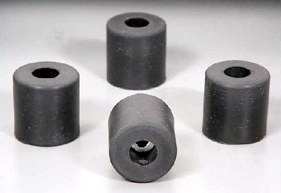

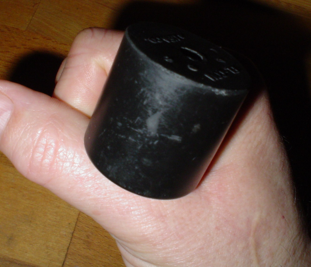

Steve Slater's wonderfeet, Ø 1.5"/38mm, couple of years ago he sent me a box of them (i tend to buy in c to k numbers)
The bottom panels of the cases i construct have 0.2" minimum thickness, why cheapskate (at $3.70/lb :clown:).
Even without machined alloy rings inbetween feet and panel, regular heatsinks are raised well enough above the stand.
www.apexjr.com/images/APEXfeet1.jpg ($0.50 each/4, $0.43 for a box of 350)
