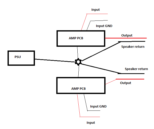

Hi Tinitus sorry if I am stretching the friendship. It would be nice if you labeled your diagram (eg Input Sig gnd, Output gnd, PCB, Power supply, star etc) and reposted it for everyone. I know it is obvious for most people but it would be good to do this for completeness.
Should it be on the pcb? Should it be at the -ve speaker binding post? Should it be at the power supply 0V? or Should it be at a remote location as discussed by Andrew and drawn by tinitus.
My next questions is how do do this? Do you guys use a terminal block as the star ground or what other ideas do you guys have.
Once we are in total agreement on how to do this, then we can talk about the differnce between monoblock and stereo configuration.

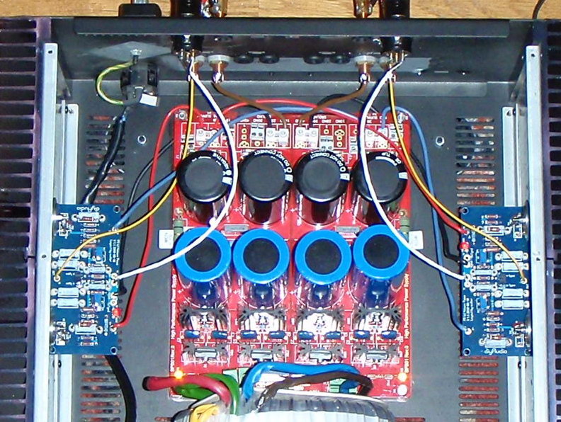

I used the psu as "star"gnd.
And it is 100% silent, (and remarkably powerful with this psu...)
You can see that speaker-gnd is connected to the psu-gnd.

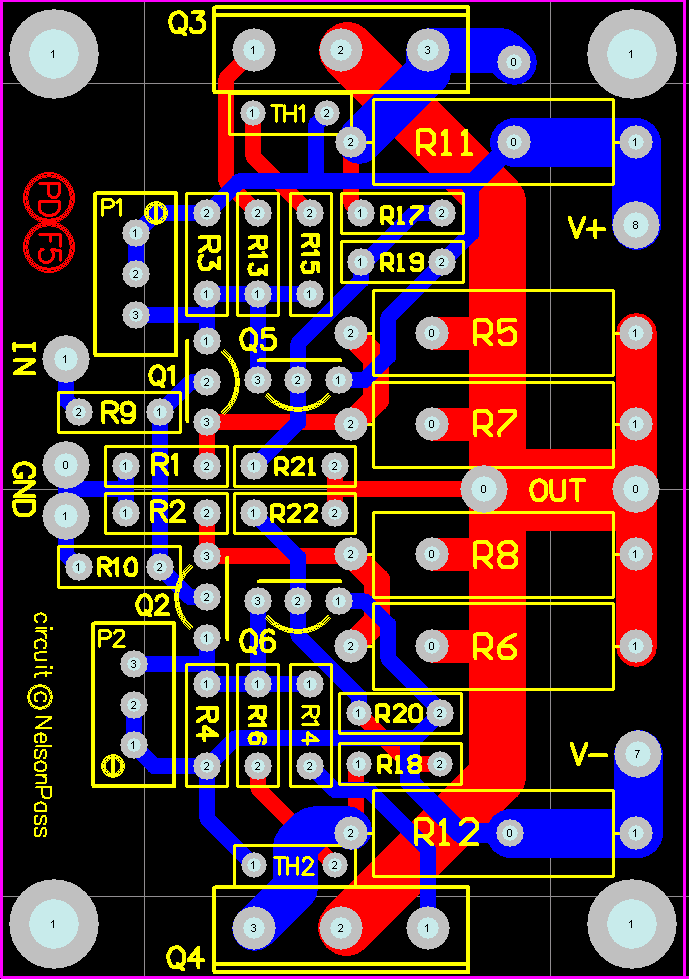

Ground connections on the F5 are :
suply cord 1 earth cable
comon of the capacitors bank
ground connection of R10
ground connection of R1 /R2 and speakers return
4 wires maybe as R10 and R1/R2 at same point on PCB
There may be a loop between the pre amplifier ground on the power cord and the screen on the patch cables as tose are comonly terminated on both sides
May be worth looking at / cutting the connection on the patch cables between the pre amp and the F5 on the F5 side as pre and F5 are already connected to ground by the power cord

He is quite right as ref3 and ref4 on the star ground are at same point on Daniels boards
so Just 3 connection to star ground

This is the grounding scheme I'm going to use.
Seems from what I have read at various places something like this should be good to use.
There theoretically might be some crosstalk betweem channels due to the common ground for both of them, but really, is it such a big difference in real world applications?
Aa long as it doesnt have any audible effect in real world applications, shouldnt we strive to keep it as simple as possible?

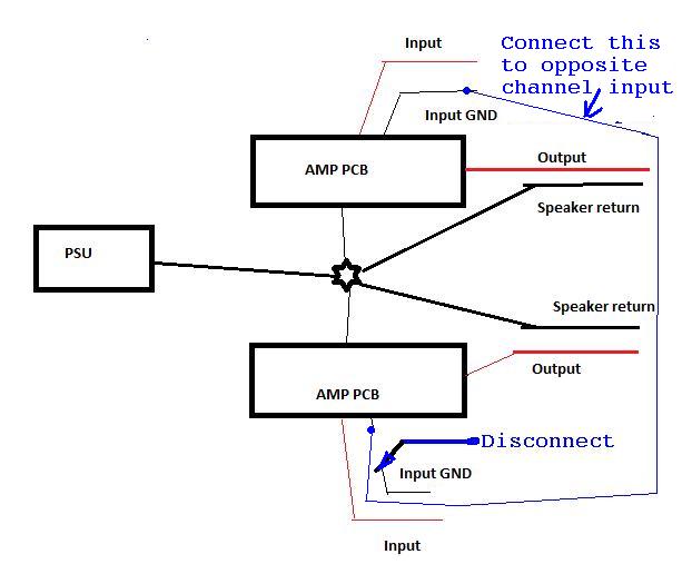

I'm reading this with interest as I still have a slight hum with my stereo F5. It doesn't bother me that much, but I plan to rewire the amp at some point and it will be nice to try the 'preferred' ground layout
If you could humor me and try connecting the input grounds as shown and let me know if your hum stops. 😉

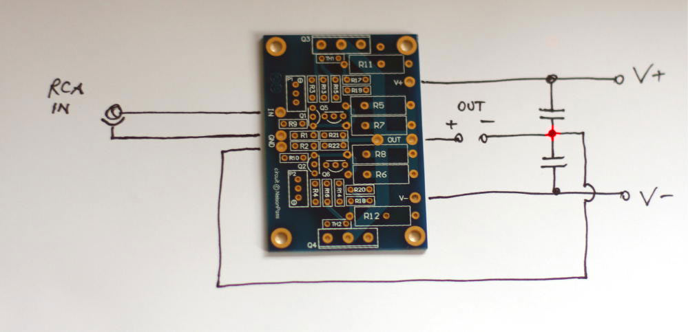

Try Peter Daniel's grounding approach, it works perfect. The red point is the PSU between the two main capacitors. Where you should connect your SPKR ground. Connect it too to the board.So correct grounding is basically annoying as hell, great.
Got to think about what Im going to do about it.
On board, the ground coming from the RCA is put there and joined to the PSU with a wire.

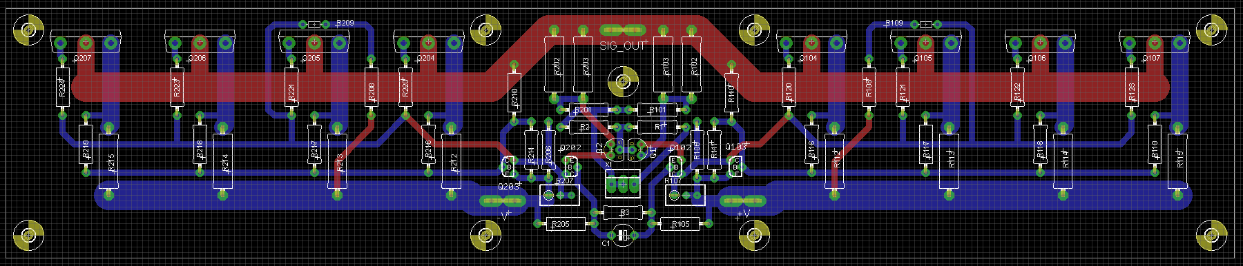

Attached are the grounding scheme plus boards layout. You can easily see how did he managed to arrange grounds. Zero noise or ground loops.

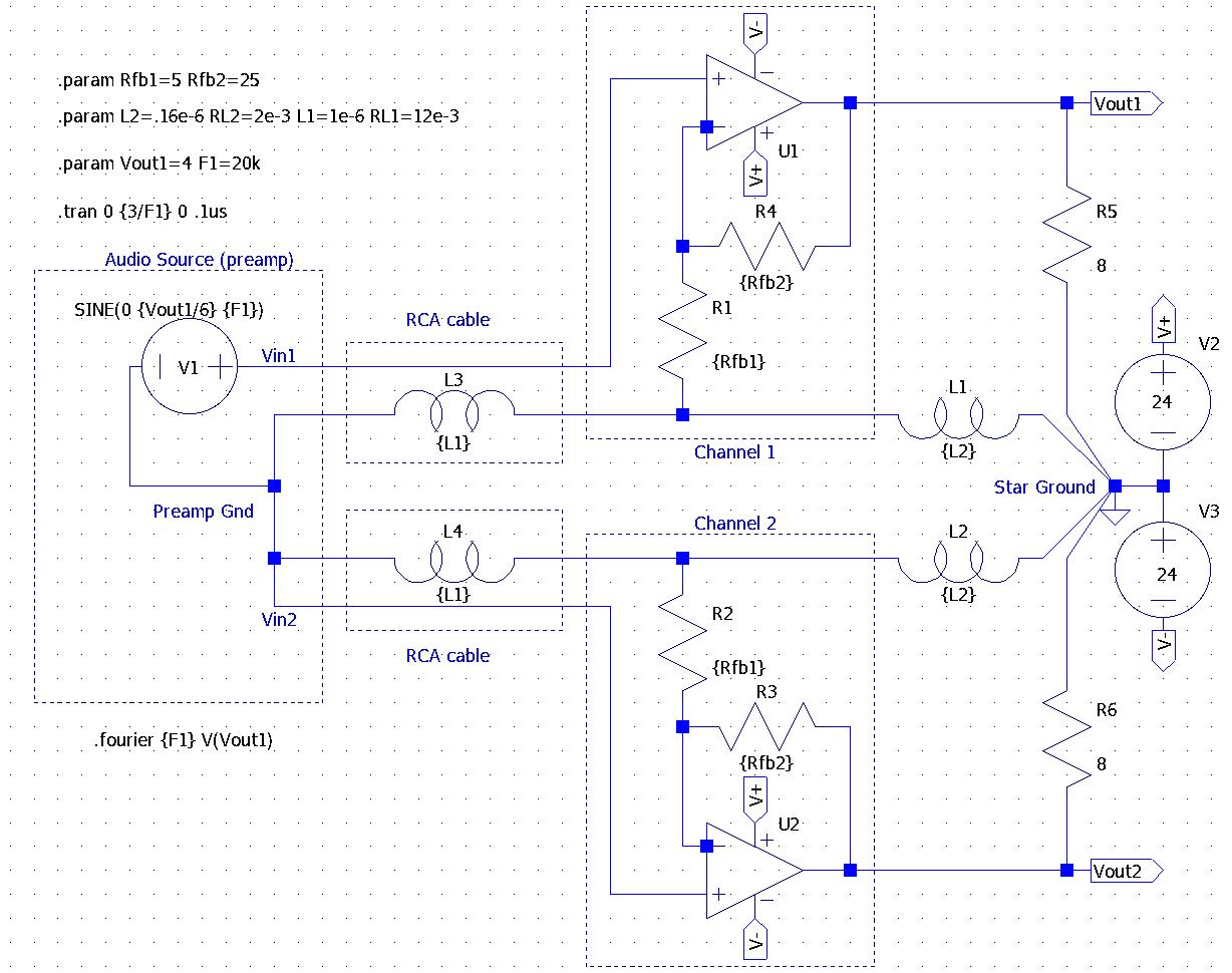

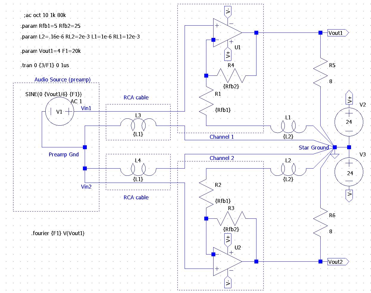

Star ground crosstalk analysis
As promised, here are 3 SPICE circuits showing 3 different ground topologies for a stereo F5. The actual F5 amplifier circuits have been replaced by OP-amps to simplify the drawings. For the crosstalk analysis, only the AC signal currents, ground wiring inductances and resistances, and ground system noise voltages are important. In all tests, the assumptions were:
. 1 watt output from channel 1 into a 8 ohm load (4V p-p).
. 20KHz sine wave input to channel 1
. 0V input to channel 2
. 6 inches of #16 wire from PC board grounds to star ground point
. 36 inches of "typical" RCA cable interconnect cable.

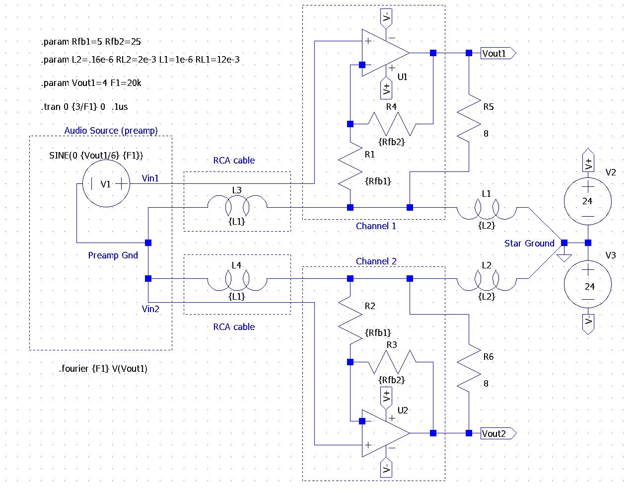

In the 1st circuit (xtalk1.jpg) the speaker ground returns are routed thru each channel's PC board. This generates 35 mV crosstalk = -41db below 1 watt.
In the 2nd circuit (xtalk2.jpg) the speaker ground returns go directly to the star ground point. This generates 7.2mV crosstalk = -54db below 1 watt.
In the 3rd circuit (xtalk3.jpg) the input grounds go directly to the star ground point instead of the ground points of the PC boards. This has least crosstalk of 500pV = -198db below 1 watt.
In practice, acoustic crosstalk in a listening environment is likely to be HUGE in comparison to any of these values. So, why is interchannel crosstalk worth much attention?
