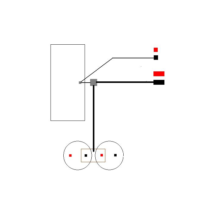

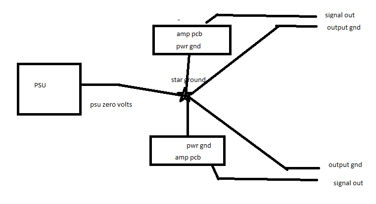

So if you make a single star ground point and connect the psu zero volts to that, then you can take both pcb power grounds and connect to that single point, as well as both output gnds should be taken from that single point.
Like attached picture.
Correct?
Correct?
and the speaker returns and the signal grounds
Speaker returns is the same as output gnd, yes?
Or do you mean that the output gnds should go to the star point before they go to the output?
Signal gnds, you want the input signal ground to go to the star point as well?
The picture in my previous post should be ok?
with a star ground I wouldnt be needing out gnd on the pcb since I take that gnd connection from the star point?
Since all grounds are connected on the pcb anyway, wouldnt it be enough with just the pwr gnd connection going to the star point? Like the picture.
in reality there seems to be only one ground needed on the board, Jfet and signal ground
where to connect speaker ground I would say depends on the distance to your supply ground
I will have about 5 centimeter distance to supply
but some will have maybe like 20 centimeter, or more
I dont know, but then I guess it matters
if long distance, I would use the board ground spade connector (faston?)
not the board copper plane, but the spade connector itself
or you could place a star ground connector very close to the board, somehow

my ground scheme suggestion
HAPPY NEW YEAR TO ALL
Well, that looks quite alright. 🙂
Maybe Ill do it that way.

Well, grounding scheme suggested by tinitus looks like a good idea, Think I'll just reduce the grounds on the pcb to an input signal/JFET ground and a ground line from there to the star point.
PSU 0 volts, PCB input signal/JFET ground, speaker ground returns, all should go to the same star point.
The potentially quite large return currents are then kept away from the amplifier PCB.
Problem solved I should think.🙂
