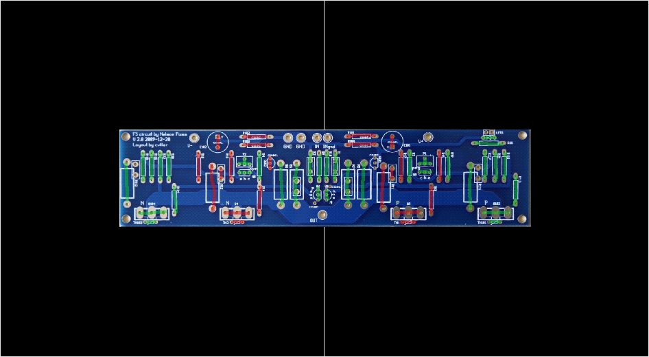

@ma_coule the offset of the F5 has some correlation to the bias level and temperature of each half of the output pair, so separating them thermally may have some implications for output offset. I had asked earlier - and Peter had a very nice solution where he thermally coupled the halves, he used a Conrad MF (IIRC) heatsink for each device, and aluminum bars to couple them.
Hi Sangram,@ma_coule the offset of the F5 has some correlation to the bias level and temperature of each half of the output pair, so separating them thermally may have some implications for output offset. I had asked earlier - and Peter had a very nice solution where he thermally coupled the halves, he used a Conrad MF (IIRC) heatsink for each device, and aluminum bars to couple them.
thank you!
BTW, what about your promised new "layouts" - kits for F5, F3 amps & IRFPs... 😉It's my old F5 layout -
