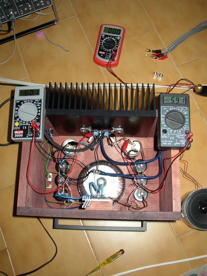

it looks like a bad solder joint.
It seems you were right, the soldering appeared all good but...
Last time I checked, I got V+ on P-ch mosfet source with pots at zero. Bending lightly the board I got zero or V+ as an intermittent contact was in action.
I've decided to populate a new board (I took a couple for spare and was a good choice at this point) so I desoldered all the components from the "faulty" one. The mosfets seem to work correctly at least with the test alazira mentioned earlier (same procedure can be found at Basic Testing of Semiconductor Devices).
The bare "faulty" board shows a very difficult continuity between both mosfet source and their relative resistor (R11/R12). Could it be the problem?
The other twin mono still works perfectly stable.
...............................This is assuming that something else isn't a wrong value or miswired or otherwise malfunctioning...
Your final words were profetic

my F5 is alive again,
after having desoldered all the components from the "faulty" board (to be clear I'm not saying that the board from PD was defective, but that the board assembled manifested a problem) I placed them on a brand new board.
I didn't get V+ on P-ch mosfet anymore but no bias at all on both rail.
Swapped the mosfets with a new IRF couple, same result.
Swapped R11 and R12, circuit at work again.
Reinstalled FQAs (the same installed in the previous board), still working well.
It's three hours since then and all is fine.
So, it seems the problem was in the two Pana 0.47R 3W. But, were they the cause or the effect?
They appear ok at a first sight, I don't know what's wrong with them. The soldering were good.

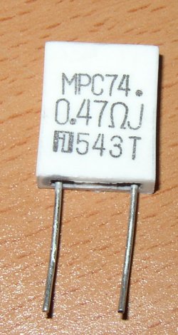

The 0.47R resistors dissipate 0.8W @ idle, but a lot more on peak -- close to 3W -- so make sure they are positioned off the board to allow free air flow.
Thank you for your suggestion. They were at around 4mm from the board. It should be enough to let air circulate around them.
I changed the two Pana with these Fukushima 5W and at this point I'll change the Pana in the other monoblock as well.
