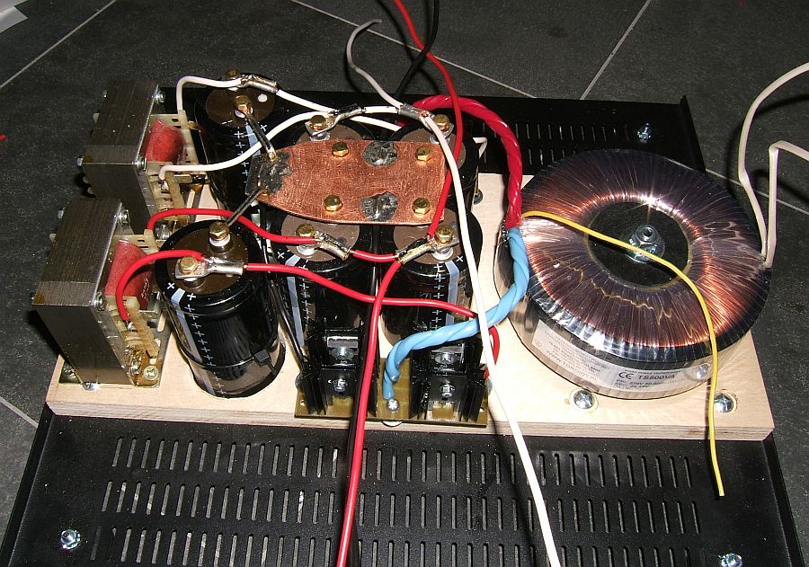

Hello,
After following this thread for a while I've started building my F5.
The power supply is finally done, it always takes more time than you think to build something 😉
Specs CLC PS: 500VA - 2x (MUR3020 - 47000uf - 10mH - 2x22000uF)
Next: softstart and drilling holes in the heatsinks.
regards,
Danny

Hi Danny,
thanx to share your work&experience with us - "behind steppers"... 😉
Hope to here from you very soon about bias setting & sound.
