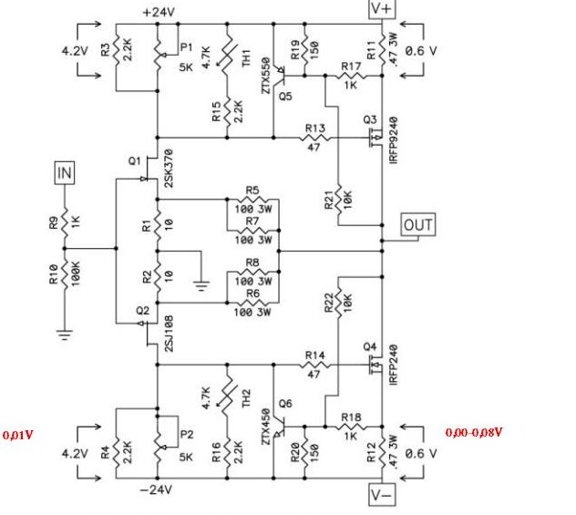

F5 one channel negative side bias problems
Hello ,
2 days amplifier sounded great in test mode , then I thought adjust bias (before real life sound tests during weekend) - and then something "mysterious" happened .
I can not settle bias for one channel negative side . Please find attached schematic with voltages on negative side. Positive side seem working. On scope screen appears distorted curve... Power supply voltage on the amplifier PCB also OK. DC offset about 1V.
Board and soldering seems ok, also output transistors looks fine. No overheating or burned parts. Which transistor should I change ? Currently, I have only ZTX speare - others i will have to order.
maybe I touched and shorted the PCB holding screw with multimeter clamp with R12 ,,,
Thanks for the hints in advance.

I am not ready to respond immediately ( I took a small break), ill measure little later, and then write (I also think maybe the SJ is dead by static electricity or burned). Thanks.
It's always the transistors that go first so please re-check Q2, 4, and 6 especially Q6. Also check trim pot...
I would say that four things could give you a voltage of 0.01V over R4. A broken pot, Q6, Q2 or a random short. Maybe check if you have turned Q6 correctly.
Thanks Cviller, i will check and then post results. Before it works fine. not short-circuit, checked several times.No one component was removed, everything is as it was before when it sounded.
Well, turned around transistors may "work" for a while and then give up - I learned the hard way. 😱

Thank you, everything ended well - negative rail missing was due to a very small gap on the trace where minus wire soldered - probably bad etching.🙁
Now its working fine.
