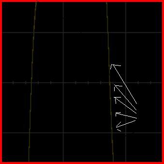

hi to all,
I have made some mesure of the out of my new build F5.
I can't obtain a square as stable as in the service manual
square wave
square wave
power noise ( in the capacitor filter)
may be, I have a grounding problem ? or the amplifier is too fast ? 160ns of rise time
test made with 8 ohm resistive load

Your top trace looks like a bit like an inductive component ringing. Output inductor ? It could be also be down to grounding, the input ground being contaminated in some way.
The middle trace is of more concern, there appears to be some oscillation occuring. Connect your scope probe tip and ground together... should be perfectly clean trace... now keeping them shorted touch the amp ground. Does the scope trace "thicken" and show that HF oscillation. If so try a low value (100 ohm say) in the scope ground lead.

looks like some oscillation which I am guessing -- but perhaps 3MHz? Just about the f3 frequency of the gate stopper and input capacitance of the MOSFET.
You can experiment with the value of the gatestopper. As the value increases the f3 is lowered, but too high a value and the amp will break into oscillation. I've used different values of gatestoppers on N and P channel devices.
On the boards which I burned for myself I have a very short run both from gate-stopper to the MOSFET, and from JFET drain to gate-stopper. I've also used everything from Ohmite TWW5, Mills, Jaro's and Dales as the 0.47R/3W resistor and haven't seen this as a source of that type of oscillation.

After some test, I have changed the 3 wires ( +, - , GND) between the capacitor of the power supply and the amplifier card to a torsaded computer lan CAT6 wire.
like this (one channel only for the test)
and this is the result of the trace , more stable than before
and this
at 20khz
and for the fun at 1Mhz
