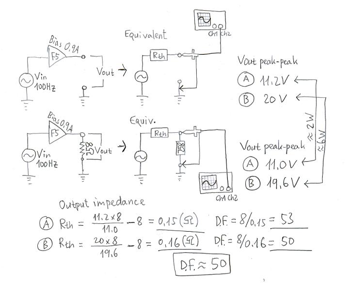

Under 8 hom load it is not +18.72 -21.2
The voltage drop at +/- 1.25V is 63mV so OI is 0.42 and DF is 18.8.
My F5 has bias of about 0.95A, compared with the original of 1.3A.
At 2W and 6W output powers (100Hz frequancy) into 8 ohm load, I find DF of about 50 which is lower than 60 of the original F5.
The lower the bias, the higher the distortion.
The question is: at which bias is that distortion audible.
