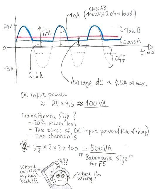

Okay, here is my way of transformer sizing . . .
Not to guide you . . .
But to know where I'm wrong . . .
It's for class A 25W@8-ohm load and for class AB 100W@2-ohm load on +/-24V rails, of course from F5 . . .
Where I'm wrong . . . ? Advice? Thanks.

I think you're making this too difficult. You should probably build it with the same parts as the original so you have a reference. Then you can try to make changes to the circuit afterward. I don't understand everything. I didn't calculate this. The original uses a 300VA Plitron and we did a Plitron group buy a while back so I bought one.
BTW the amp idles at 62 watts/ ch if built as per the original circuit.
Yes, I am.
Large part of my head is occupied by useless things . . .
I agree . . .
