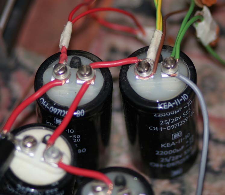

I got buzz - ground loop issue
are there separate power ground and signal ground
at my setup everything goes to central ground at the filter caps
I don't use safety ground wire at the moment
samoloko said:I got buzz - ground loop issue
Only the mains ground (earth?!) goes to chasis. See to gather all grounds into a single point between your PSU filtering caps, and from there, via a thermistor, connect the amps GND to the same point on chasis where you connected the mains grounding. Meaning, there should be a NTC (~10-20 ohms) between "signal" and mains grounds. It's simple and then you shouldn't have any audible noise from the amp. However, you should connect the safety ground wire to the chasis. Amps often pick up crap and amplify it, if not grounded properly
DO NOT put your main Audio Ground on the wire/trace/plate between the smoothing caps.
Instead place the main Audio Ground near the midpoint of all the points that need to be referenced to it.
Then connect the PSU Zero volts between the smoothing caps to this Audio Ground.
Also, connect the PSU Zero volts to the chassis using a disconnecting network.

Investing into a few decent eyelets to make connections between the caps would surely help to do it much better than this... We all know you can 😉 http://www.diyaudio.com/forums/showthread.php?postid=1612093#post1612093

AndrewT said:DO NOT put your main Audio Ground on the wire/trace/plate between the smoothing caps.
Andrew sorry for the ignorance but what do you mean by disconnecting network ?

Probably meaning the same what I tried to explain. A thermistor between chasis and PSU zero volts.
2 thermistors
Stein, You could emphasize the use of a seperate thermistor for each channet PSU 0v to the GND terminal, as your photo in post 1801. There is one thing that can easily be done to improve performance - replace all those damn block bridges with good quality shottky diodes - even the humble MUR820 type devices will return big improvements in clarity, transient response, base, etc and the use of m/oxide power resistors between caps will now "not have to choke off the diode noise, etc" - another improvement. (please excuse the tortured wording - like me, also needs upgrading!) You may have seen the use a small resistor (about 0.1R)between the diodes (bridge) and the first cap (the "Ripple Cap") - it doesn't work in all circumstances and for all types of caps, but as it's a simple exercise, just try it - it normally adds extra smoothing and detail to the sound, despite the "SIM" programs saying the opposite. Another thing that's often overlooked is the use of really good wire throughout the whole amp, not just the input & output connecting wires.
