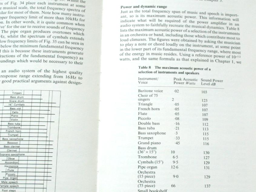

They should have had to bring their consideration of the peak acoustic powers of instruments and voices into their thoughts, too. Each instrument or voice has difference. For example, if we compare peak acoustic power Watts/ sound power level (SPL) dB, it is as follows:
- Pipe Organ: 12.6 W/ 131dB
- Bass drum: 10 W/ 130dB
- Trombone: 6.5 W/ 127dB
- Singers: 2 W/ 123dB
- Grand piano: 0.45 W/ 116dB
- Trumpet: 0.33 W/ 115dB
- Double bass: 0.16 W/ 112dB
- Piccolo: 0.08 W/ 109dB
- Flute: 0.05W/ 107dB
- Triangle: 0.05W/ 107dB

This is slightly misleading since one usually does not stand in the loft with the pipes, and the organ is played in a very large room where you the listener is a considerable distance away... I also am pretty darn sure that a flute can do more than 107dB (assuming these are 1M measurements?) when played to do that.
Almost no one has a home hi-fi system that can even produce one (1) acoustic watt...
_-_-bear
bear said:
This is slightly misleading ...
... a flute can do more than 107dB (assuming these are 1M measurements?) ...
Could be . . . Anyhow, the point is why the smaller amp is acceptable for high part in bi-amping.
Yes, watts/sq.M, and dB is re 1 pico-watt/sq.M.

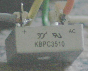

I got low rails - 22.2Vdc when loaded
before bridge - 18.5 Vac
Is this normal
also the bridge Is very hot
Is this normal

The testing F5 I've built (now rebuilding from scratch) had 17.8VAC on bridge (Graetz) and around 21.8VDC on amp, loaded, on a 500VA transformer with separate secondaries for L & R channel. Found that it often depends on the transformer, but never had the bridge getting hot . (35A/250V, one per channel) ... what bridge do you have?
You might want to check the current capability of the bridge and if its ok, then you may well need to heatsink it. I know I had to heatsink mine.
Fran
Fran
samoloko said:here is bridge
I bought It at about 1 usd
anyone know what brand Is
That's 35Amperes, 100Volts, use a small bolt and fix it to a metal (preferably Aluminium) surface, that should do the trick. The bridge itself is ok.
