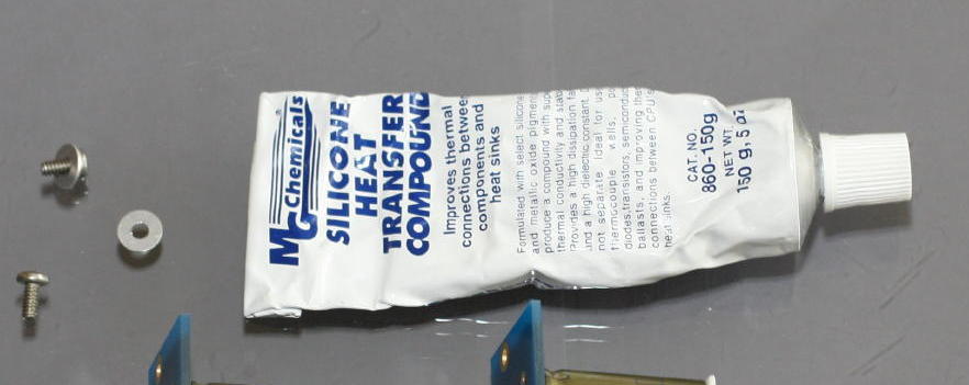

Yes, a little bit of grit will do it. Something else to watch out for: If you are using the mica spacers meant for TO-3 transistors (the keystone ones posted back aways) note that they have extra holes - if you orient them the wrong way around one of the holes is under the mosfet and you will get a short. Also make sure your heatsink surface is flat around the tapped hole etc.
Take off your boards, clean the mosfets and spacers with some alcohol, do the same for the heatsink. Then use some fresh heatsink grease and affix again. Check for continuity. When the mosfets are hot check again - I lost some of the source resistors cos of some grit/metal swarf that only shorted when the heatsinks got hot.
Clean it all down and put it back together again - I'd be very hopeful it will be AOK then.

Peter given the above advise would you advise against silver impregnated grease vs straight heat grease- believe it or not my local radio shack has three different grease coupounds- no mica but three compunds!-
I am using the t-03 mica.Wwould I be better off trimming the holes off and putting two together?

I would advise using silver impregnated grease. I have found that when you apply pressure this kind of grease can become conductive and blow up your circuit, even though its not supposed to do this.
Now I use the plain old white stuff and don't feel guilty about not going high tech.
