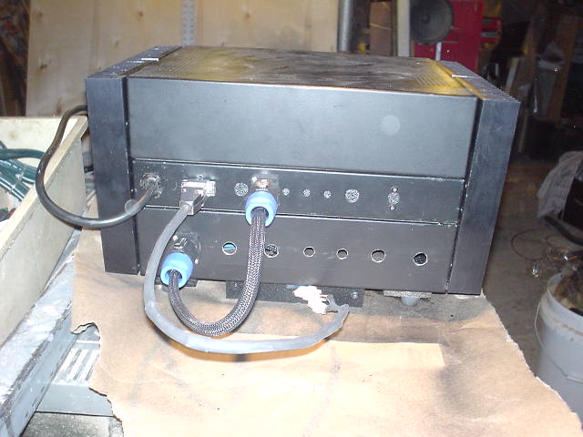

Back view before speaker or input connections-
thick cable carries raw positive and negative rectefied voltages down to the resevior on the bottom level- other cable is to bring the power and control voltage up to the fans on the middle assembly
#584

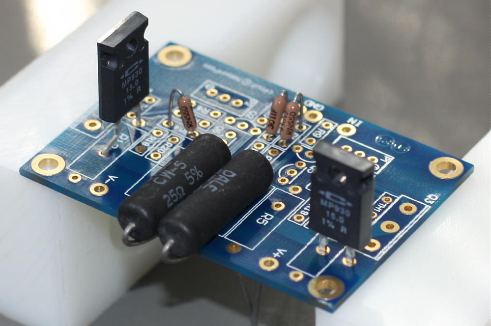

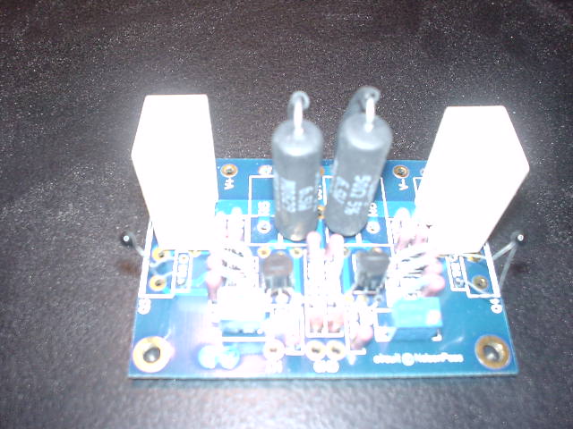

final pic- stuffed board
sorry about the focus, or lack thereof but wanted to show the tight fit will the dale resistors and the insulators(leg warmers)
also the vishay ceramic .47 r11&12 are big on the Daneils board so I added some wire jumpers to enable the nec measurements once the boards are mounted(per NP's instructions on bias setting)
Not ragging on Daneils or Tech-Diy just mentioning the adjustment that I came up with as necessitated by the confluance of the parts

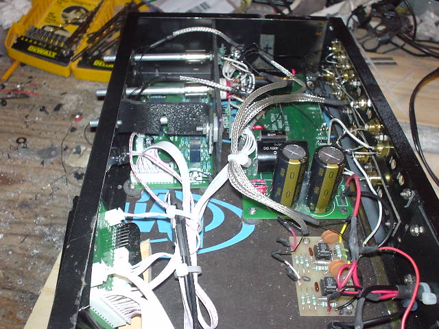

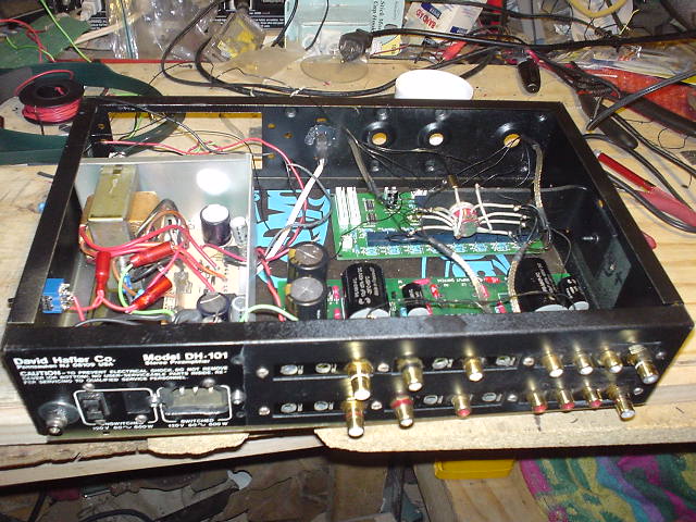

It actually works well- You can source halfway decent rca on a strip to replace the nickle orginals- move the power supply outboard- you can reuse it or upgrade and BBP has a nice little remote driven ladder volume and 4 source switcher called R2R that I used and liked
here are some pics
here are some pics
f5/b1/hafler rebuilds
eventually I went outboard with the power supplies(5volts @ 1/2 amp for the switcher/vol and 19 volts for the B!) added a second buffer for the tape out(based on an old AA design using the NE5524) and dynamatted the floor pan- I really like the dynamat!
I rused the case work and aluminum knobs- with a few aluminum strips and some flat black paint I'm happy with the results- Just have to finish the markings on the front pannel and of course add the PassDIY logo
Hope this helps
rob
Hope this helps
rob

Good work! My Hafler has been sitting in the closet for years and I've been trying to find a chassis for my B1 so why not. You've inspired me I think I'll give it a go
rob lenk said:It actually works well- You can source halfway decent rca on a strip to replace the nickle orginals- move the power supply outboard- you can reuse it or upgrade and BBP has a nice little remote driven ladder volume and 4 source switcher called R2R that I used and liked
here are some pics
I have the same boards and kits. I was also looking at those dales and wondering how to fit them. Thanks for the picture. Where did you put these jumpers? Did you just run a small wire from the lead?
Kris

I just tagged them underneath at the solder points and left them long enough to reach beyond the board by an inch or two- I will heat shrink the ends after measurement= little prophylactics!
Again I wish to make it clear that Peter's boards are great- just had to figure out how to fit the Tech-DIY parts and the vertical mount seemed best- Peter's suggestion with the big Dales would certainly make sinking Q1&2/Q5&6 much easier while soldering them in place-
rob
sts9fan
