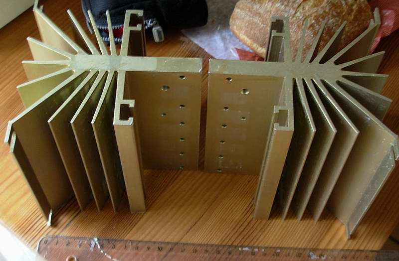

Re: F5 Heat Sink Dissipation
Hi, the house is still standing 😀
1) after readjusting mfet spacing the temp was at 45c after three hours.
Keep in mind I'm testing in a 60f basement, and the sink is open on all sides i.e. no casing.
2) setting the bias was a snap, using thermistors & current limiters, and the bias is at 1.08amps and very stable. Today, I will adjust it to 1.2amps.
3) Fets spaced from edge to mounting holes is, 2"__3 1/2"__3 1/4"__1 3/4" .
Fets are 3/4" from top edge to top of fet. Clamps will only allow that
Yes, mounting the fets as per CViller, see below, should even out heat distribution and give cooler results. After running the amp upstairs in 68f~69f ambiant temp I'll check the temps again. I'm using a cheapo Cen-tech meter to measure the temps, I need to check the accuracy with an ice cube and boiling water as a range check. 0c--100c 🙂

The optimal vertical placement of the fets is 1/3 from the bottom, but I guess you already know that.
I think you might be pushing it by running two channels on one conrad sink - when you put the whole thing in an enclosing, the sinks will loose some efficiency and even worse if you place the amp in a audio furniture later on. Lowering the bias will give you more distortion.

Re: Re: F5 build on one Conrad-151 hsink
Why do you say this? I think it may be the opposite. Has to due with air flow along the fins. If you heat up the air at the bottom, less temperature difference between the air and heat sink at the top.
bobodioulasso said:http://www.conradheatsinks.com/technical-details.html
scroll down to: heatsink proportions.
That is indeed an issue with vertical. As is everything, there are pros and cons.
the usual recommendation for location for small heat sources on a big sink is ~ 40% up from the bottom.
The ratios change as more devices are added in the vertical direction.
To get good dissipation from any sink, the temperature of the backplate should be near isothermal as it is when tested by the manufacturer. This requires the radius from [devices to extremities] / [backplate thickness] to be ~ 10:1
Very tall and/or very wide sinks cannot approach optimal isothermal conditions with few heat sources. Give the sink the best chance to achieve low operating temperatures. Thick paint, horizontal fins, enclosed sinks, sinks sitting on carpets, facing down sinks, facing up sinks, dust build up on the dissipating surfaces, etc. can only increase operating temperatures.
