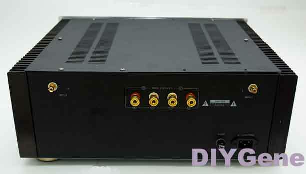

Ichiban - I'm dying to find out if the house burned down yet, because I'm planning on attempting the same crazy $#@* with a D-988 amp case, (see photo). The Conrad MF35-151.5 has a thermal capacity of ~ .2 degrees C / W. Using my expert photometric capabilities and scaling by fin area, the D-988 amp has about the same fin area and thermal capacity per side - so I should get the same results. According to Pass, at idle, each FET will need to dissipate ~30 watts, so your heat sink should be about 25 degrees C above ambient.
Three questions - 1) where did the temperature settle out at the FET's after a couple hours, 2) did the bias stabilize and at what current, and 3) how far apart, laterally, were your FET's, (I can't tell where the heck they are in the pictures). Also, do you think mounting them towards the bottom of the heat sink would have helped ??

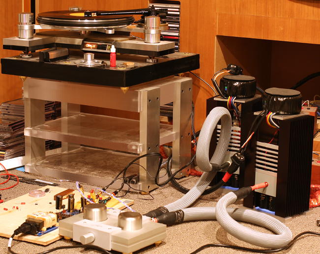

Peter Daniel said:
Then I thought why not removing all the parts that are not really needed and off went current limiting circuitry: the amp opened up and instead of boring became much more interesting and involving ...
I hardly understand how come the sound has been opened up after romoving the current limiting circuitry. The Q5 and Q6 are off, doing nothing, till the amp see the maximum current, say about 10A 😕
I know you have a special ears diferrent from the ordinary people, tho . . . 😉
Well, if you read F5 article you may notice that I might not be the only one giving current limiting a "bad rap". 😉

You forgot to look at the Conrad spec sheet and particularly the de-rating information.
When DeltaT is less than the test value used by the manufacturer then the sink MUST be de-rated according to the manufacturer's graph or formula.
When the heat source is connected to one small area of the sink instaed of spread across the whole heatsink area the sink must be de-rated for the temperature drop to the extremities. Again manufacturers give some guidance on this.
I suspect that two devices on a wide Conrad sink that is rated @ 0.2C/W will rise not 25degC, but more like 35 to 40degC.
