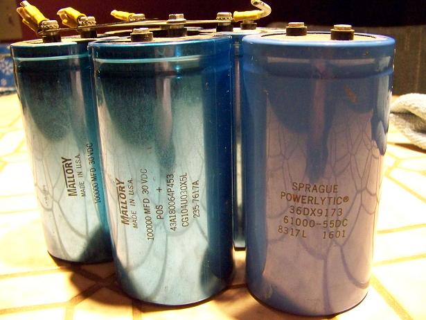

Use these or new Pannys?
I have four each of these beasts.
100,000MFD @ 30Vdc and 61,000MFD @ 55Vcd
Six inch height and three inch diameter.
Should I save forty dollars and use these if these don't
test leaky OR should I go for new Pannys 15kUf~22kUf ?

It'll give a number of people here hives to hear me say this, but I've used old caps on a number of occasions and had no problems. If they poop out on you, it'll smell bad and you'll have to buy new ones, but as long as you're not standing on top of them when they vent, you'll live to see another day.
Moral of the story? If they've been sitting for a long time, apply voltage slowly, and at the end of several feet of wire.
