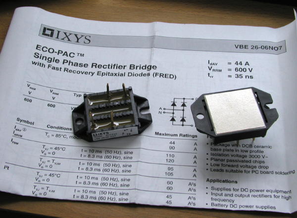

Peter,
I'm wondering if you know of a good sounding bridge rectifier in a single 35 Amp package ?

labjr said:Are you soldering the grid-stopper resistors to the MOSFETs ?
Both in F3 and now in F5 I'm using IXYS. Bought them years ago through the forum, but I guess Percy carries them too.
I intend to also try discrete diodes.
Those aren't the diodes with the overshoot problem are they?
