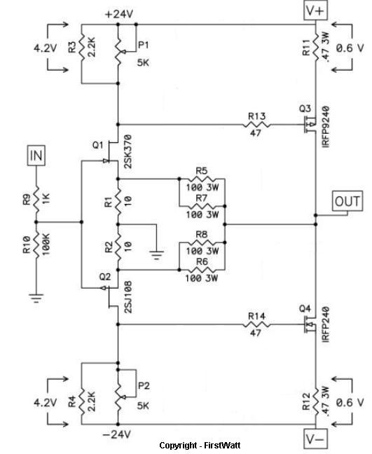

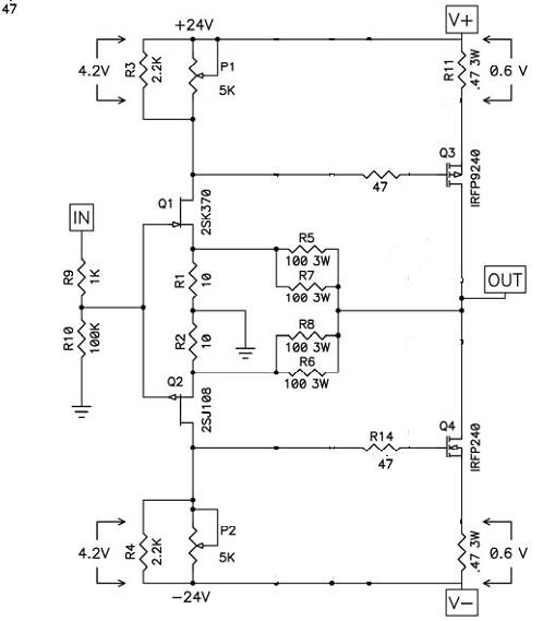

When NP says to adjust P1 and P2 for minimums at startup I'm assuming that is zero ohms across, such that Q1/2 drains are at the rails and Vgs to outputs is 0v. Then ease into the pots (increase resistance) alternately to develop/increase voltage across R3/4. Is that correct?

When NP says to adjust P1 and P2 for minimums at startup I'm assuming that is zero ohms across, such that Q1/2 drains are at the rails and Vgs to outputs is 0v. Then ease into the pots (increase resistance) alternately to develop/increase voltage across R3/4. Is that correct?Trying to avoid big smoke signals.
correct .
Thanks ZM. I drove about 6 hours today, then spent the rest cutting and tapping metal and soldering pcb's. My tired head said the Mosfets couldn't wake up as long as all that was true. Once I erased the current protection parts and ignored the double feedback loops the remaining circuit is ridiculously simple so it makes sense now.

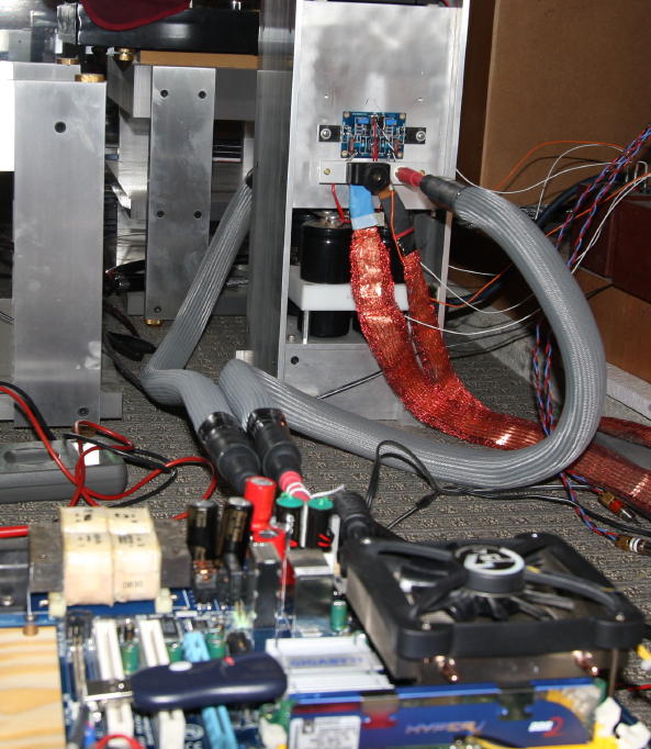

Speaker cables are Omega Micro (copper ribbon with active mesh shield). The interconnects are from a local guy who was developing cables for over two years and finally came with a product that apparently is quite good and according to him better than Indra.
