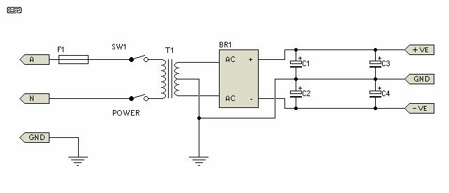

I've got a Zen V4 built which uses a single rail power supply - each channel with a 300VA transformers, each with dual 18V secondary windings. When I built it, I assumed that if I were to build another amp, I'd just get new transformers, but now the cost savings of re-using the transformers looks too tempting.
The problem is that the Zen V4 used the secondary windings in series to give 36VAC, so I trimmed the unnecessary leads really short and then soldered them together. So my question: if I'm to reuse the transformers for the F5, can I use a power supply with just one rectifier bridge like the Zen V4? It would seem that using dual bridges with the windings in parallel gives 2*25VDC = 50VDC, or one bridge with the windings in series would give simply 50VDC. Am I missing something? Er, rather... what is it that I'm missing? 🙂
If I can't use just one bridge, I'd have to unsolder the tied together leads and take the odd step of extending them. oi - heatshrink, I guess.

Sorry for the newb question...
-j
To clarify, it would still be a dual-rail supply of +/-25VDC. I've seen other dual rail supplies with only one bridge rectifier - I guess I'm just wondering 1) if it's possible for the F5, and 2) if so, what are the drawbacks.
thanks,
-j
thanks,
-j

I would just build the recommended power supply. It's part of the magic of the circuit. Not really a whole lot of work. Check out this post.
http://www.diyaudio.com/forums/showthread.php?postid=1486149#post1486149
