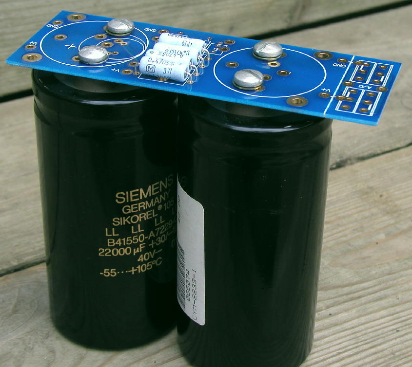

I'm intrigued by the possiblity of using some large 'screw-mount' caps on the PSU board. I'm assuming I'll have to drill my own holes.
Any words of caution???
And, do any traces on the bottom need to be cut???
I've attached an image from earlier in the thread to show what I'm talking about...

No traces need to be cut, just drill proper holes and remove solder mask.
The board you see in a picture above had the holes already, as it was designed for F3 amp where only single positive voltage PS board could be used, hence I made it suitable for screw mount caps which usually come in larger size.

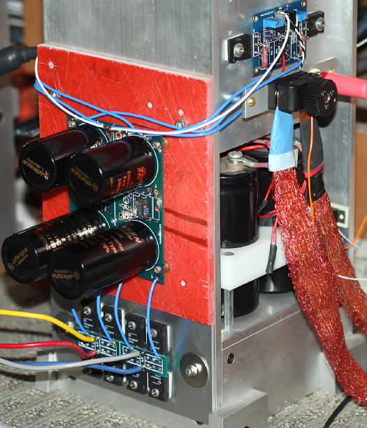

I didn't even consider using rectifiers without heatsinking, so it's hard for me to say how hot they normall run. My PS pcbs allow mounting rectifiers directly on a chassis, which I find more practical than additional heatsinks. Picture below shows one of my (temporary) test setups:
A HA (heatsinks for rectifiers)
I seem to always forget that the leads can be bent!!!
Thanks for the photo.

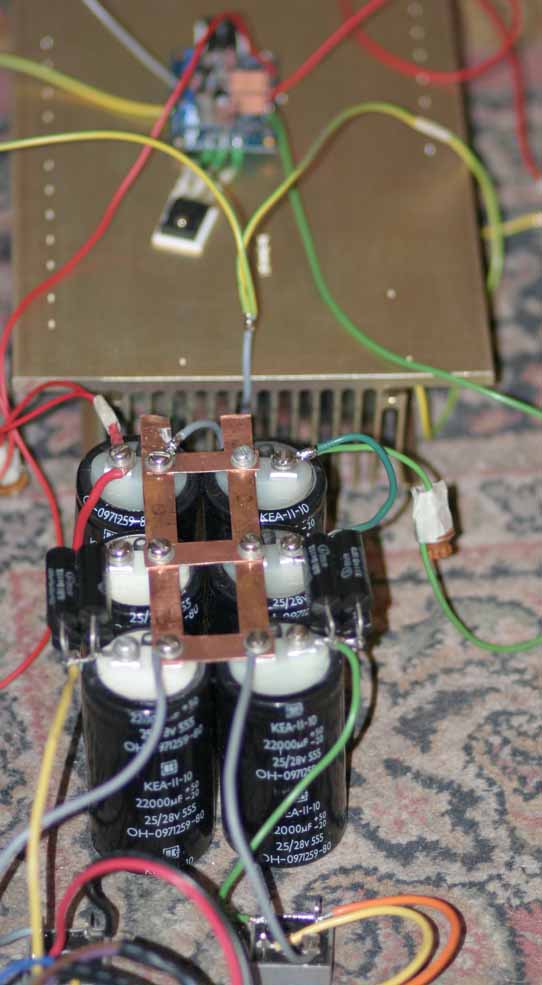

would you please advise best way to do gnd connections using your F5 pcbs
I ask because I got ground loop issue although no connection on input and even using just one amp pcb
my setup - gnd Input from rca - gnd pad of F5 pcb
rails gnd pad of F5 pcb Is fed from gnd of PSU filter which can be seen with yellow wire
brown wire goes to gnd binding post

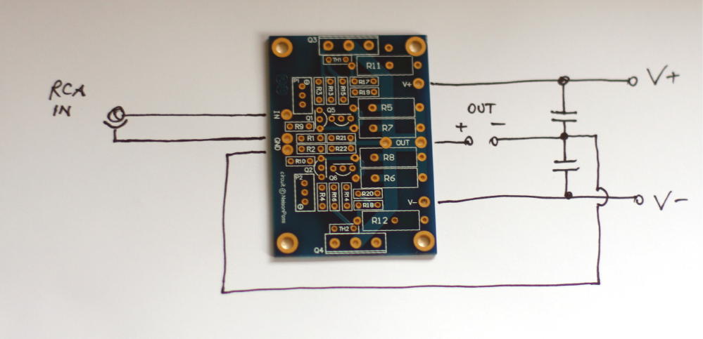

There is basically only one way to do it and it shouldn't produce any ground loops:
samoloko said:Peter
thx Peter
I have connected as you post but there Is buzz
when short input to gnd - buzz disappear
If It Is not a problem would you tell how you have connected your setup from previous post - the filter caps that are not mounted at PSU board

Maybe you could post a picture of your setup?

That is not exactly from middle of filter caps, you split the ground in two after grey wire "extention" . How about connecting both yellow wires directly to copper strips on filter caps?
thx Peter
at first I had connected both yellow wires to the gnd of last filter cap
http://www.diyaudio.com/forums/showthread.php?postid=1807410#post1807410
but after Andrew T recommendation - one post ubove I did extension with gray wire
one last thing - I don't have safety network - I only experiment at that point
