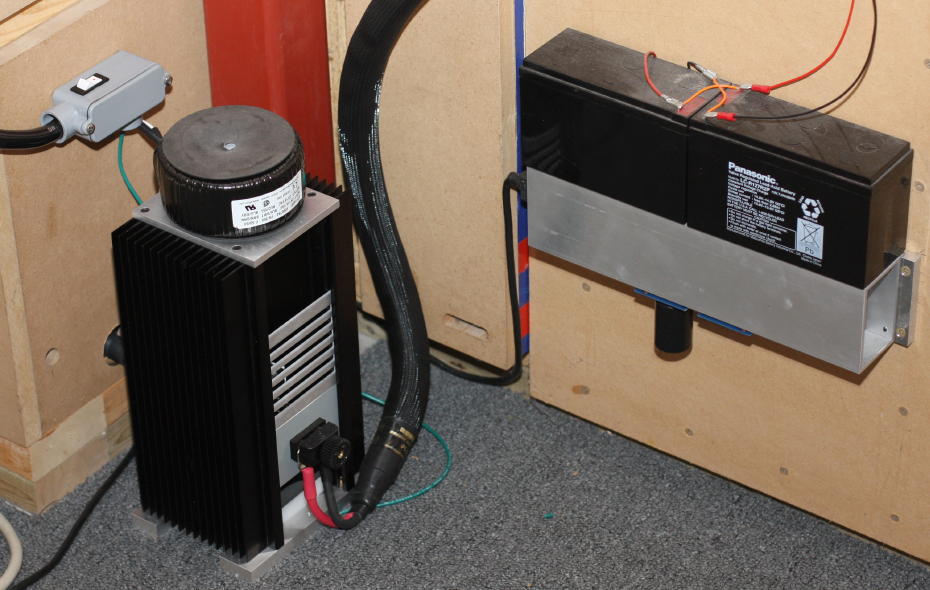

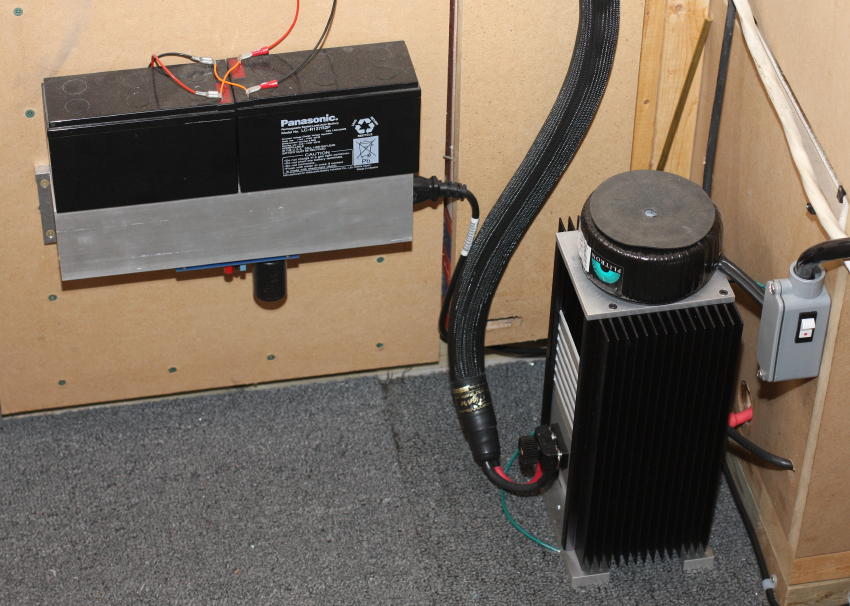

Please see attached pic for my current setup. As mentioned earlier, the amps are behind the separating wall, in which Fertin drivers are installed. You will see battery driven (charger permanently in parallel) field coil supply.
There is no power switch directly on the amp, I installed it in a special housing on near cabinet wall.

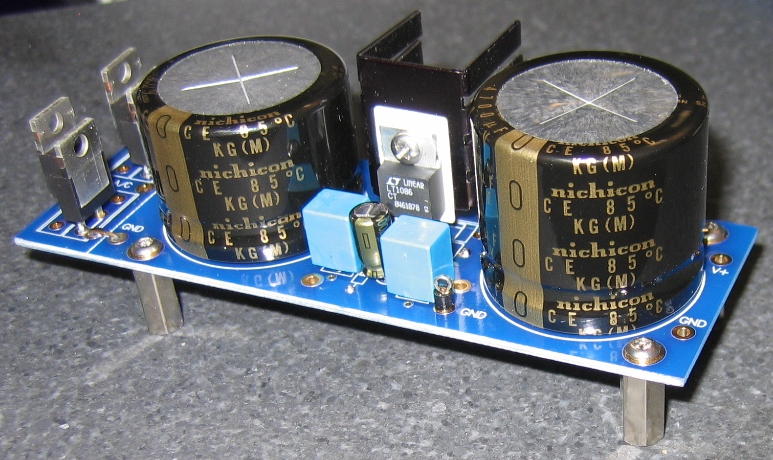

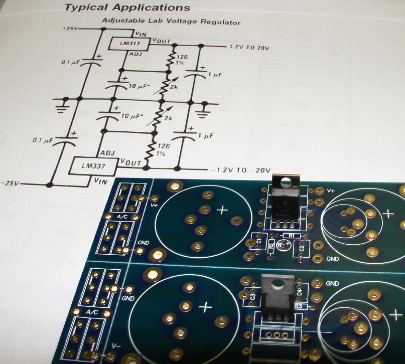

Do you have a BOM or parts recommendations for the Power Supply board shown in Posts 13 and 35 above??? It doesn't really look like the PS on the Pass website.

looks like a regulated PS
Looks like a regulated power supply.
Look at the LM317 data sheet or in this case the LT 1086 data sheet, page 14, top right hand side.
Neat little circuit, use them a lot; but I like to use the protection diodes you will see on the top of page 10 of the 317 data sheet. Not sure about using huge output caps either.

But these only do as much as 1.5Amps. Nowhere near enough for an F5. What am I missing?lgreen said:Looks like a regulated power supply.
peter
ah
ah...yes. The biggest ones I have seen are the LM138 and LM338 which will give you 5 amps max.
I do not believe that this board is intended to power the F5. You rarely see these used in power amps for the reasons you have noticed- lack of current capability... maybe only in a gainclone or something like that. There are other boards for the F5 power supply I believe.
