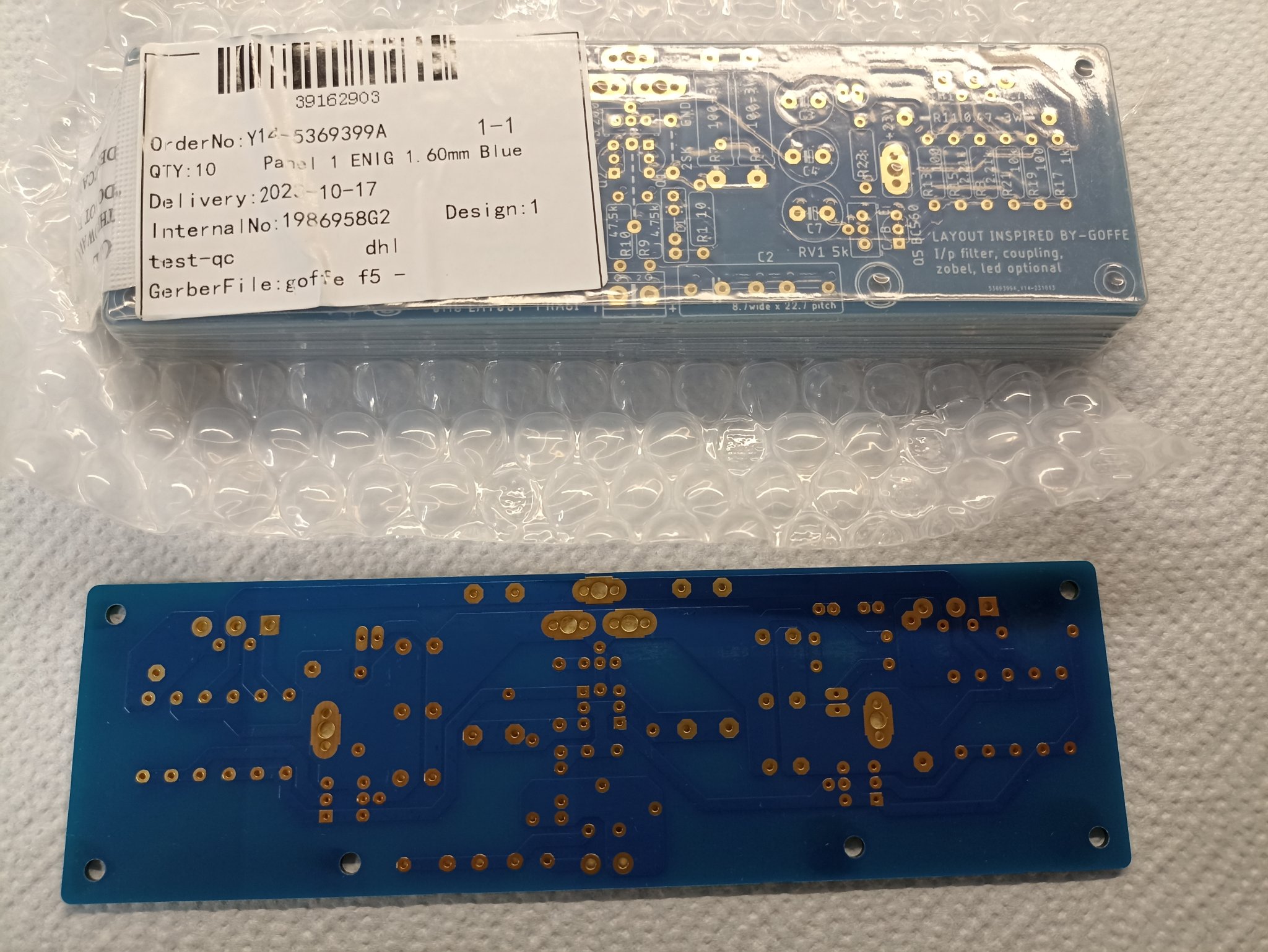

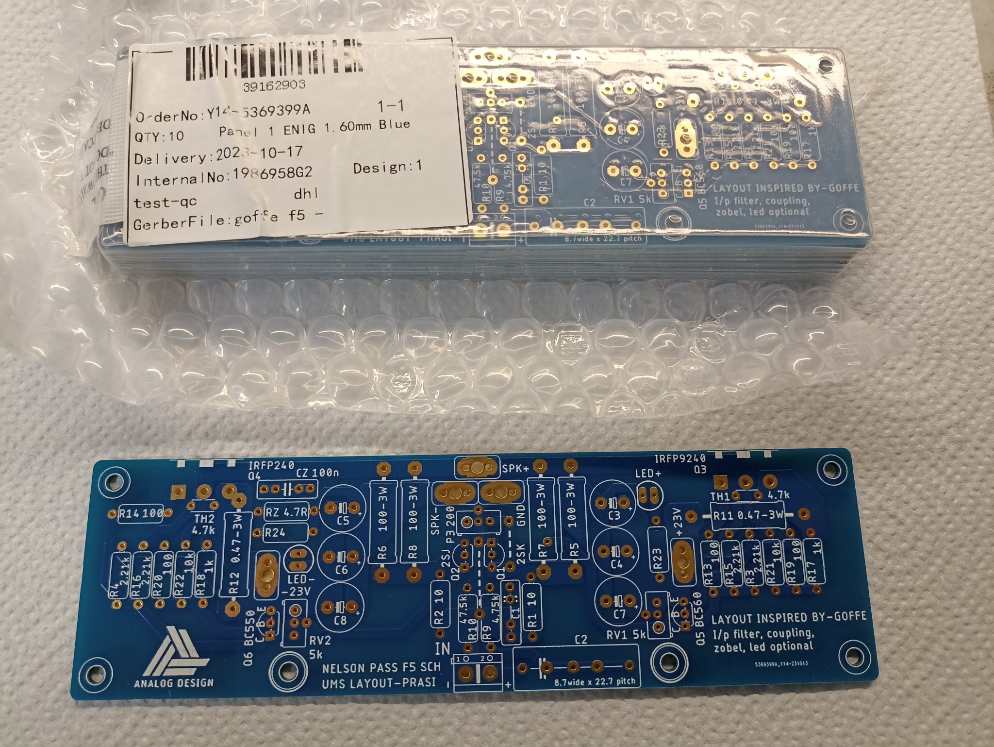

Thanks again Prasi for your work.
for me it is christmas time😁 ~140€ for 10pcs. in 6 days is ok for me

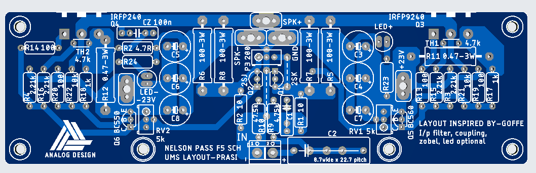

See post 5 and 7, these caps are not in the original design.What are the values for C3-C8?
Yes of course, what values are you suggesting? Can one just leave them out? I searched those posts you mentioned. DIYHarry suggested 1000uF.
be a FAB... use 220uF to 1000uF ... its got the correct current return path if you connect spk- here....
dont use a 100nF or 1uF poly cap for decoupling.....
read bespav posts..
dont use my pcb withot the decoupling caps, inspite of advice otherwise...
Prasi, you´r right,be a FAB... use 220uF to 1000uF ... its got the correct current return path if you connect spk- here....
sry, thought on bybass caps...but this is wrong...
it is decoupling for nearest possible power delivery (lowest ESR)
See BesPav: https://www.diyaudio.com/community/threads/f5-layout.307664/post-5080711

Just to be clear, C2 Panasonic 10uF, C1 should be a…?
thanks for your recommendations.
