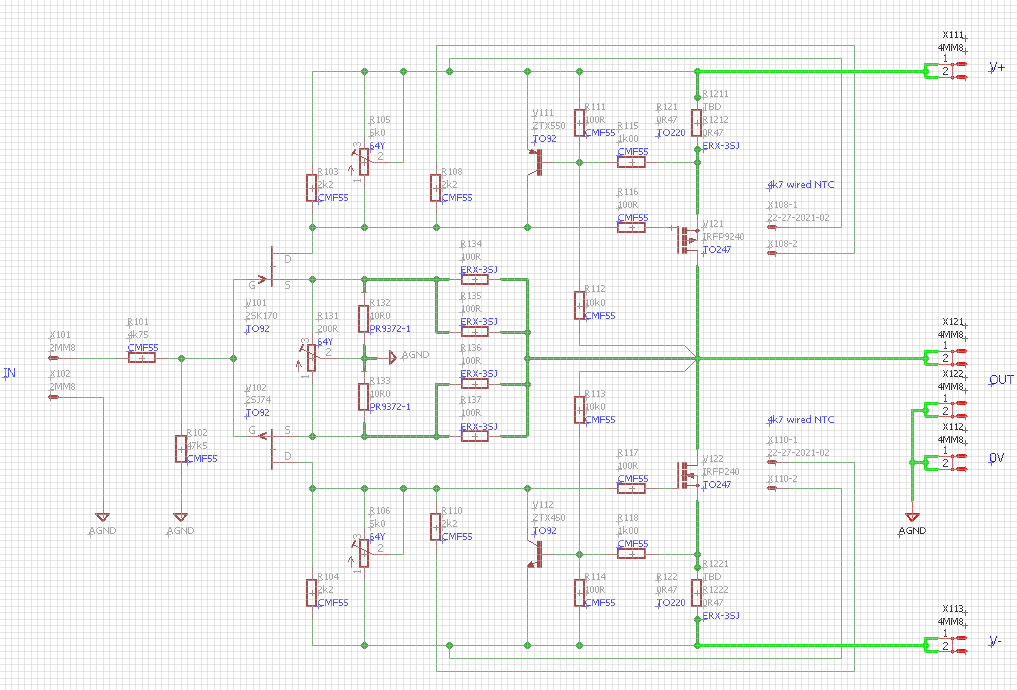

Wanted to make a layout for F5 as per fig 1 of http://www.firstwatt.com/pdf/art_f5_turbo.pdf for those who to want to etch their own pcb.

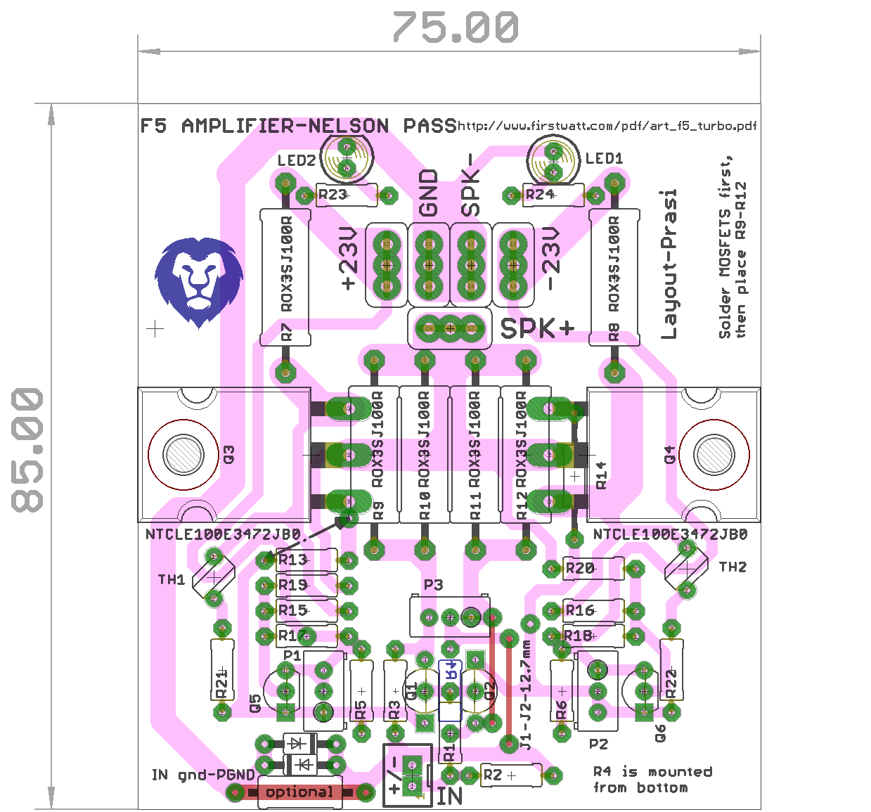

here it is. any comments on the layout welcome🙂.
the ground lift components (anti parallel diodes and resistor) are optional. LED and its resistor are also optional.
mosfet mounting hole center to center distance is 64mm.
Is it enough that the NTC touches the Heatsink?

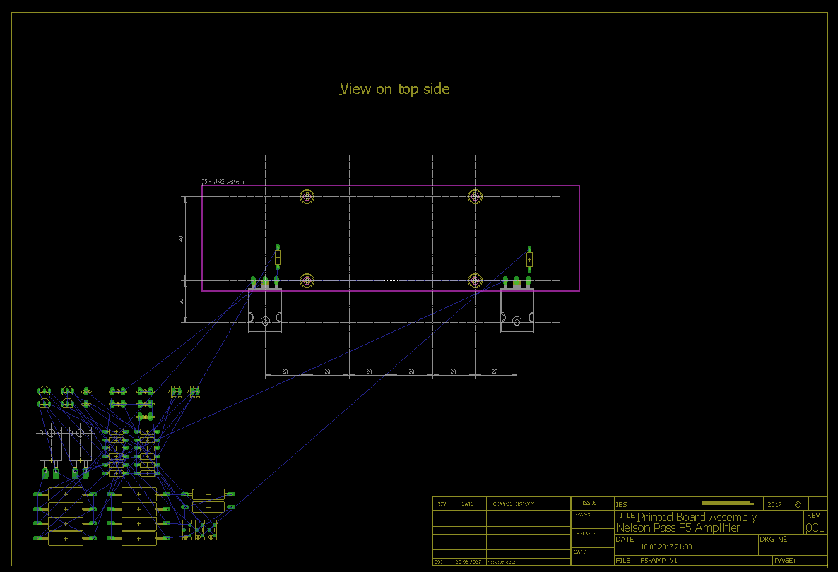

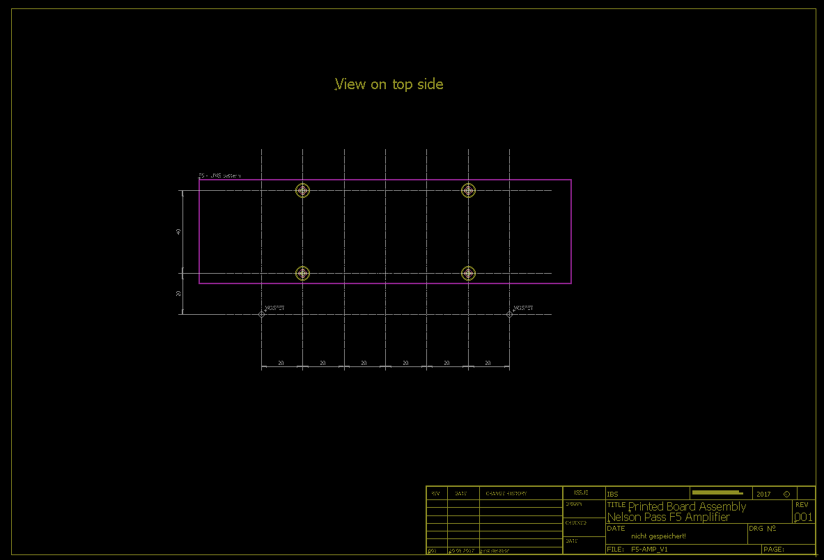

The first thing I would do is to make it mountable on the UMS standard from diyaudio, this makes it easier for people with heatsinks drilled with the UMS patern.

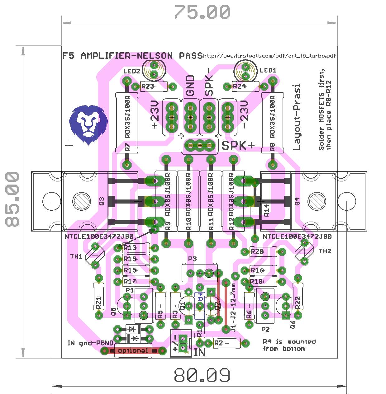

Thanks, I believe its possible to make the mounting distance as 80mm by moving both the MOSFETS by 8 mm in the above design.
The PCB will still be supported by MOSFET body like shown below.
hope you understand what i want to convey.
It's better to provide local supply decoupling with 16/18 mm capacitors (LS=5/7,5 mm) placed near the OPS and small-signal circuitry like this:

output MOSFETs are too close - put some distance between them to avoid creating a hot spot (each of them is dissipating almost 30W). Thermistor should be close to MOSFET so they can be in direct thermal contact.
