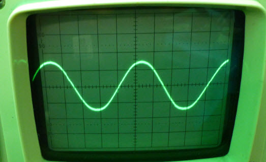

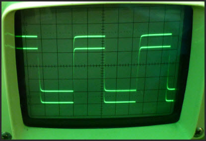

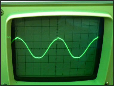

Finally got time on Sat morning to get one channel up. Looking good. Bandwidth exceeded my micky-mouse function generator's 140KHz limit. Mothers day here today so I'll have to wait until next week to put the second channel together. Then temp box it up and sneak it past the 'trouble and strife' into the lounge room for some listening sessions.
First 2 scope shots are input trace ontop of output trace 10 KHz and 100 KHz (see what I mean about my toy function generator). Not quite square trace is 10 KHz. Input below output. The gain is a bit under 5x.
I left out the local filter electros for the time being. Seems OK. I also replaced the 100 ohm jfet gate resistors with 1k as suggested by Patrick.

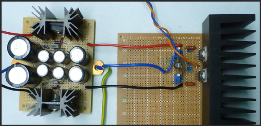

Well, we'll see how well the PS copes with double the load once I get the other channel up and running.
Yes, no hickups.......but I spent much more time checking my circuit than building it. 🙂
I've found that spending time triple checking is always quicker than troubleshooting a blown up one after I've let all the smoke out.
The load would be the least of the problem for your cap multiplier.
If anything, you will probably get more problems from two high speed circuit sharing the same supply interacting with each other.
(i.e. potential oscillations)
I am actually quite amazed that you did not get any already, despite the long distance between the last cap and the F5-HA.
But we'll soon find out, I guess. 🙂
And yes, very wise to spend time checking rather than just power up blindly and hope for the best.

I will be cutting down the board width when complete and so I’ll make sure the PS is closer, leads twisted etc. Perhaps I’ll put in the local caps as you have.
In very rough terms, what sort of freq range would I be looking at for oscillation? What sort of voltage swing? (I’ve never built anything with this sort of bandwidth before) My scope is just an old CRT 35MHz jobbie.
A few MHz, full voltage swing.
You will not miss.
And add things one at a time (local cap, 2nd channel, .....
Else you have no idea what causes the instability.
Patrick
