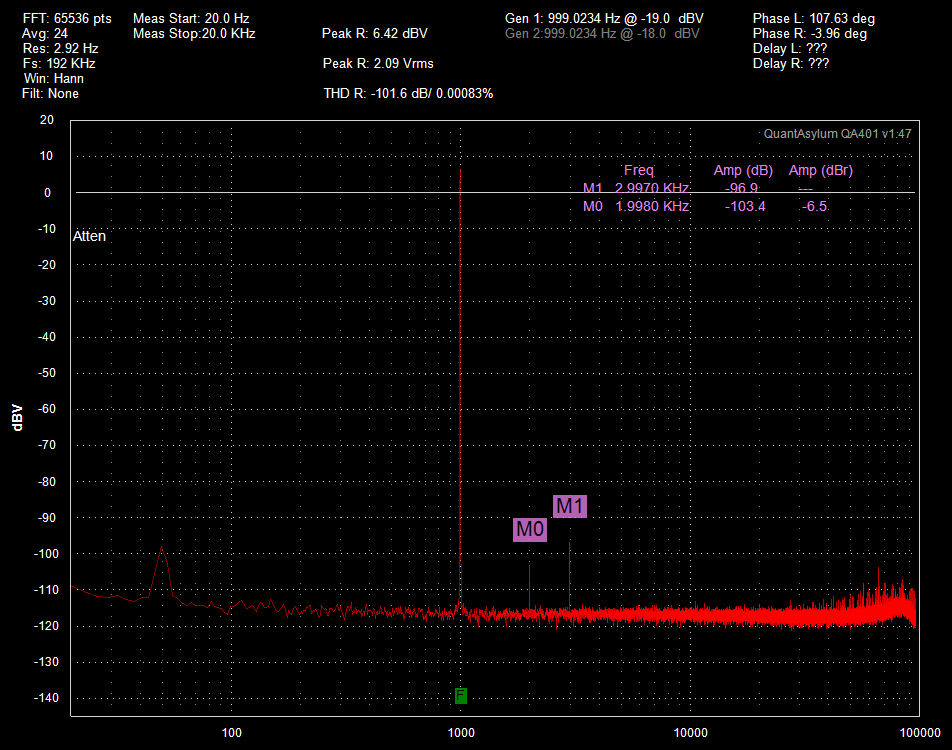

At 2Vrms into 300R, relative to the 6 dBV fundamental :
H2 -109dB
H3 -103dB
H4 <115dB (limit of the measurement equipment)
H5 <115dB (limit of the measurement equipment)
As a benchmark, the Pass HPA1 is quoted to have a THD <-86dBV at 1Vrm, 30R.

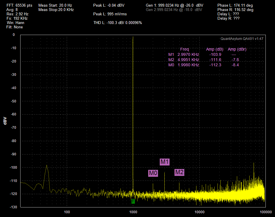

At 2Vrms into 300R,
H2 -83dB
H3 -112dB
H5 -112dB
https://passlabs.com/amplifier/hpa-1

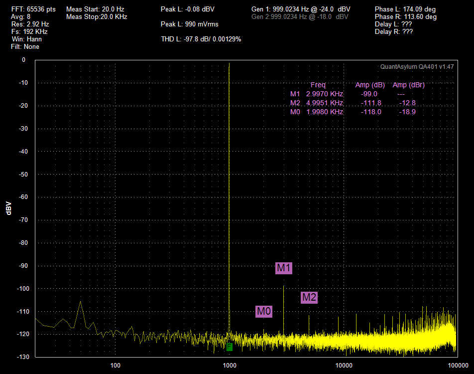

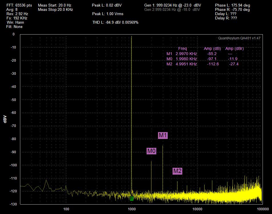

At what bias is this? And when do you expect the boards to be for sale?
I asked the same question but find no answer while boards apparently have been for sale. The fact that many don't know says the "GB campaign" was not successful.
Patrick please give a link where we can find the original boards with prices etc.
Bias was 150mA.
Increasing bias to 250mA will lower distortion into 30R load even further.
But we need a better heatink enclosure first.

Could someone find the bias value so that THD is mainly H2 and H4 with very low H3 and H5 (the worst). My headphone ar 56 ohm.

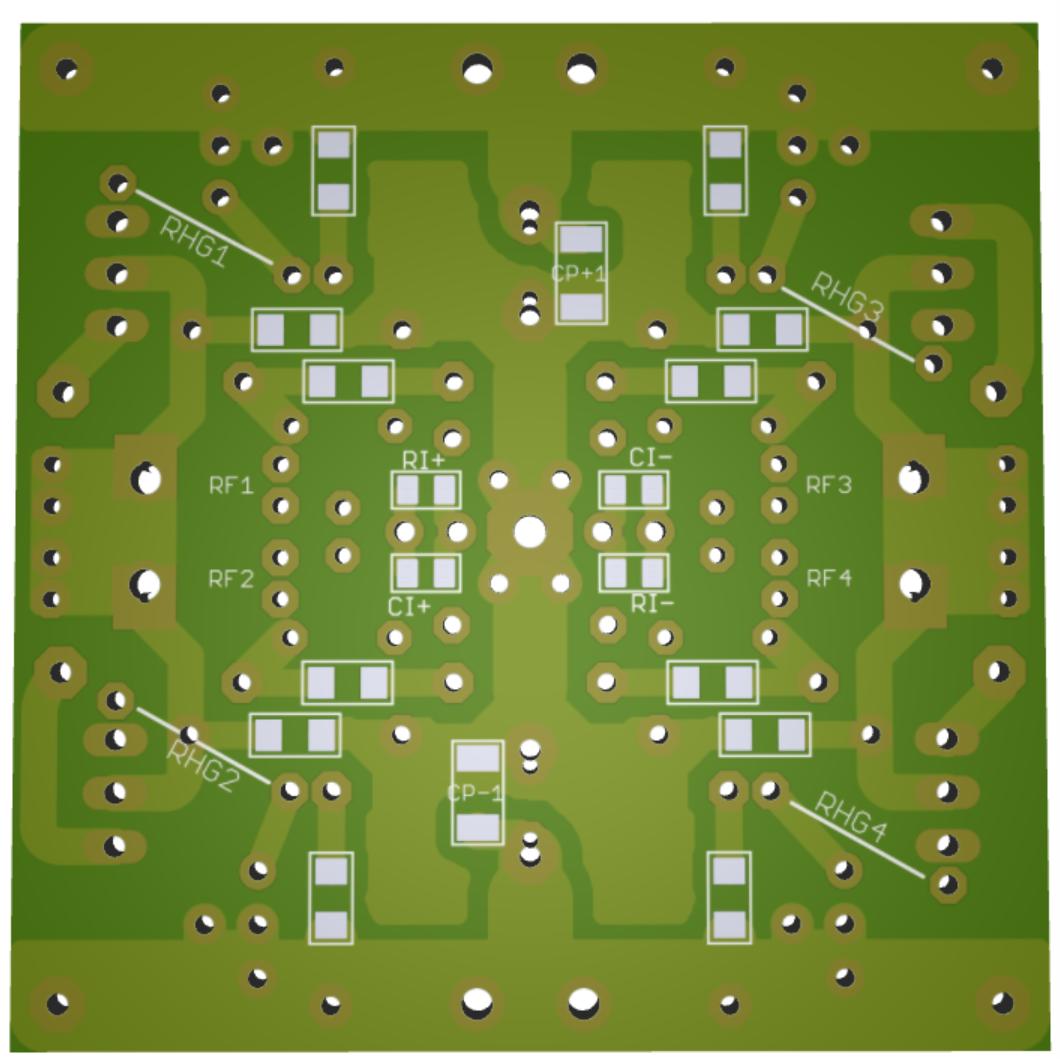

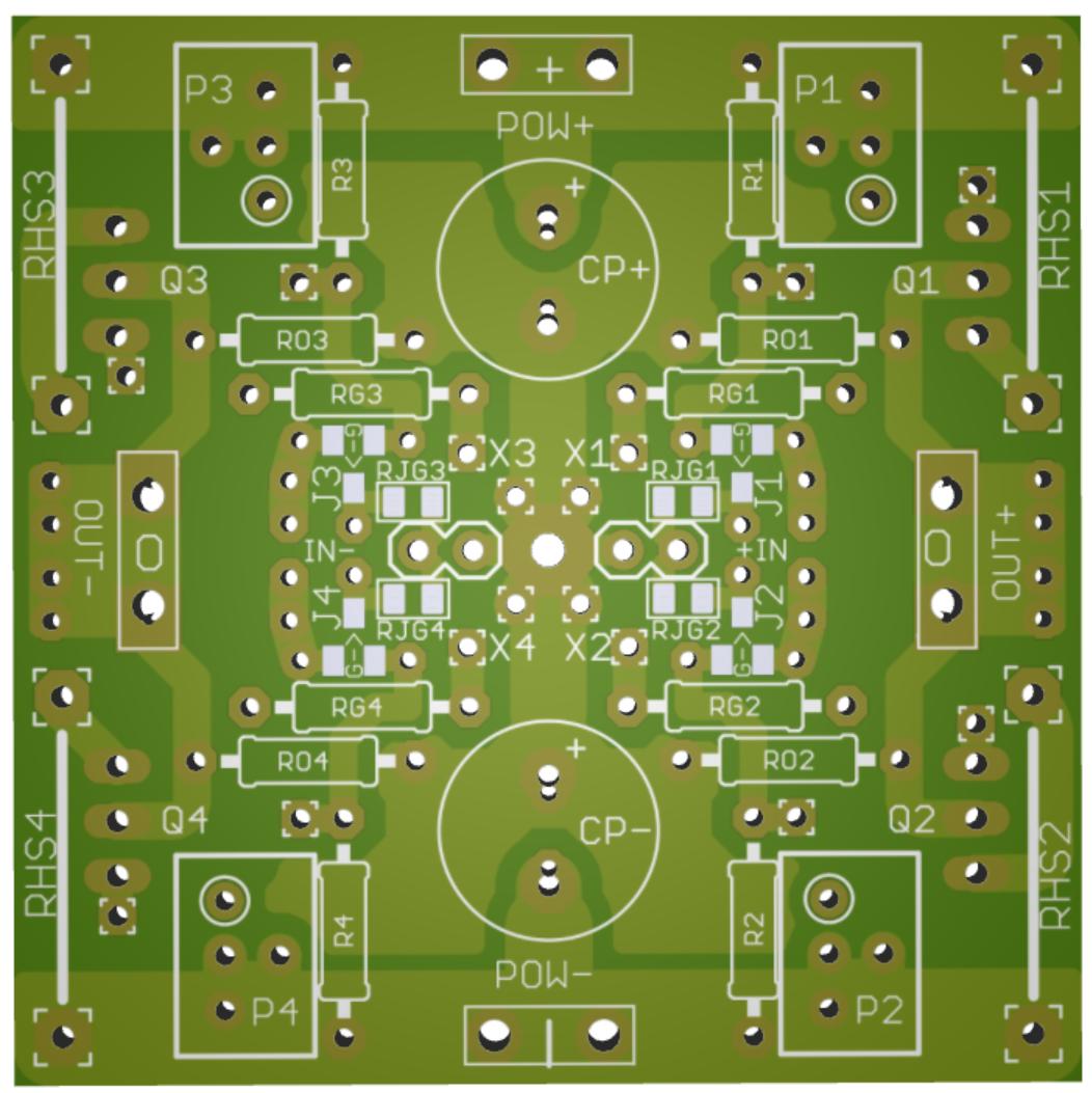

I can't tell if above is double sided - maybe not? Would it be too much to ask for a single-sided home-etching friendly version and pdf's?
