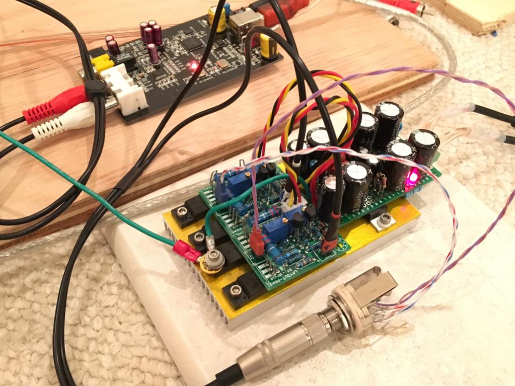

2SK2013 and 2SJ313 & Cap Multiplier Sounds Fantastic
I converted the power supply to a CRC upstream of the cap multiplier by adding a 4.7R and then added another 2200uF on the output cap after the multiplier. I added an earth ground and ground from star hub to heatsink. The hum is gone and the amp is dead silent with a cheap pair of 19v SMPS. So we can now move the main bricks outboard of the amp box and use standard 5.5mm round power supply jacks. I used the Fluke to measure the AC mV and got 0.0mV. With my good headphones attached and no input, the amp is dead silent.
I have played a few of my favorite test tracks and so far it sounds exceedingly good with 165mA bias current. This is now a very compact and portable amp if placed in a smaller chassis. Chassis cover can still serve as heatsink to dissipate heat without needing real fins I think.
The sound of the 2SK2013/2SJ313 vs the IRF610/9610 sounds like perhaps more detail, and more crisp bass. All subjective thoughts of course. But overall, a great sounding headphone amp.
Here is the amp under test with the XMOS U8 & Burr Brown PCM5102A DAC as source. These two units could probably be combined in one box for a DAC and HA in one even.

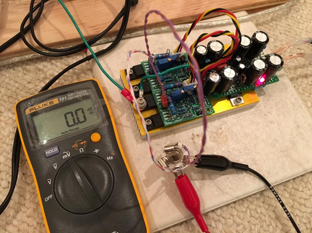

Here is the noise measurement:
