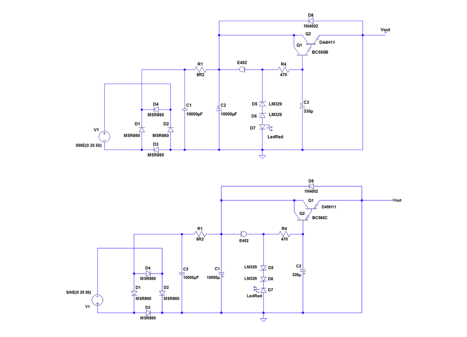

Schematics of the cap multipliers attached. I am using a string of two LM329 and two red Led's in my build to arrive at 16.4V.
The transformer is a custom wound toroid with two shields and 2x18.5V, so plenty of overhead. No mechanical hum, no noise.
Sinks of the supplies are temporary of course, didn't have anything better at hand Final wiring will also be nice and tidy.

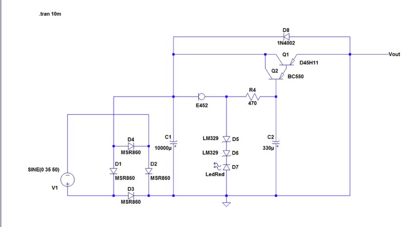

Stixx: In the original schematic you posted you show an 8.2R resistor between the power caps which form a CRC filter. In the schematic on your website you are showing a single cap, no CRC. Any preference here? I will use a 18V transformer.
