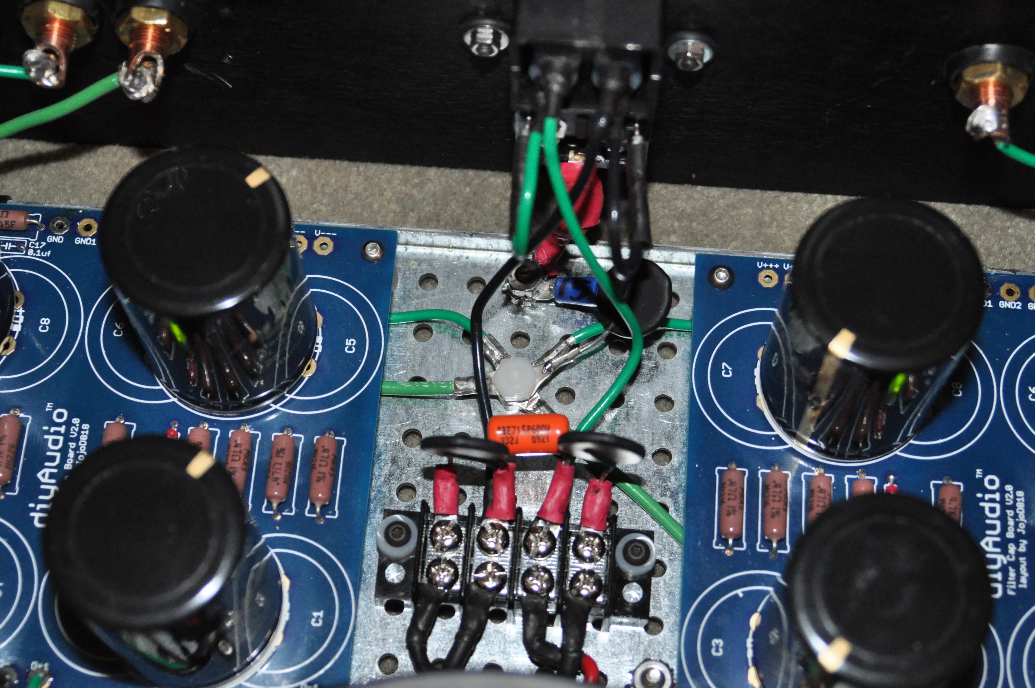

Main Audio Ground will be totally isolated from chassis (no contact) and connected through CL-60 to the Chassis Earth bolt..

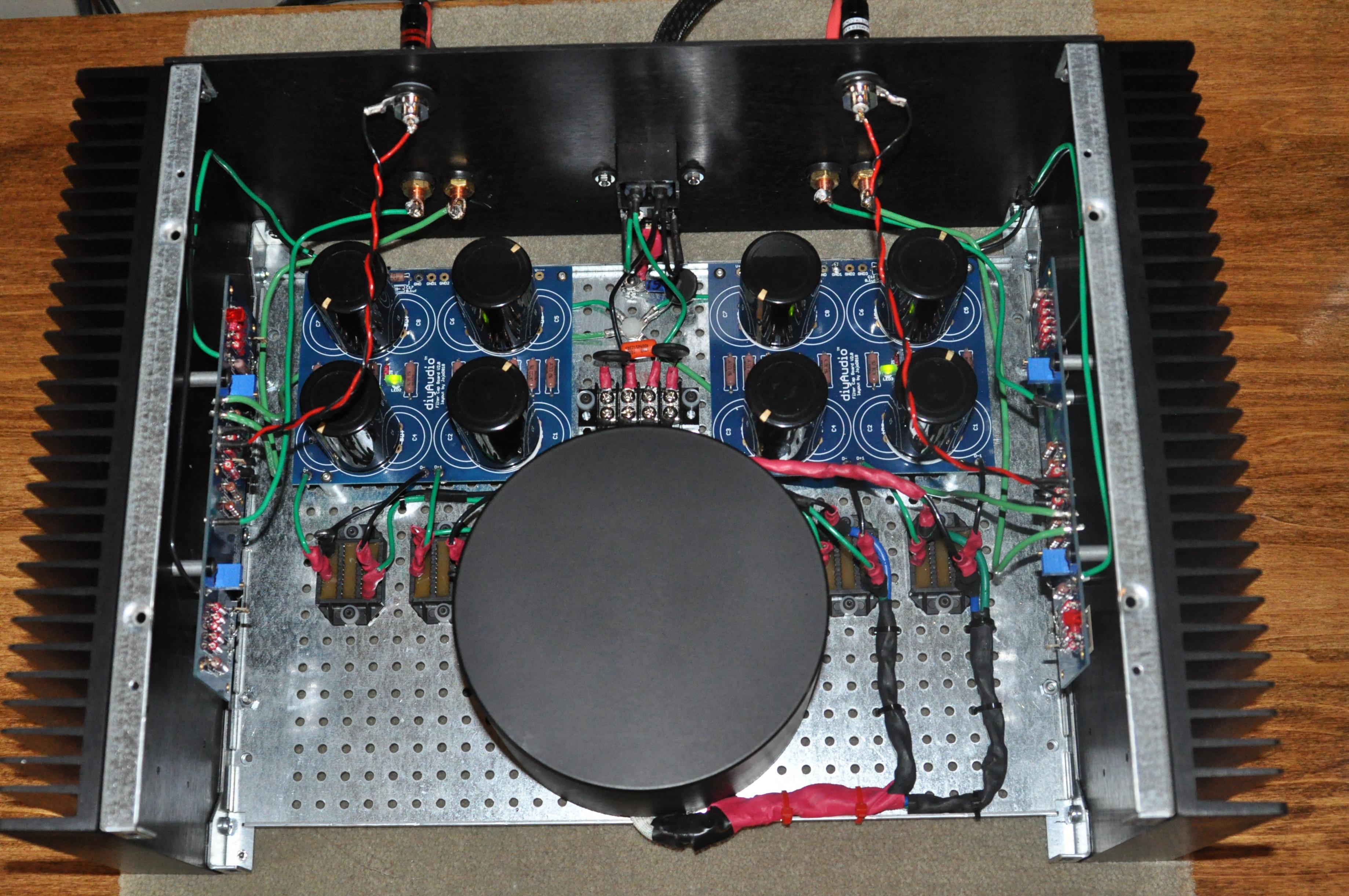

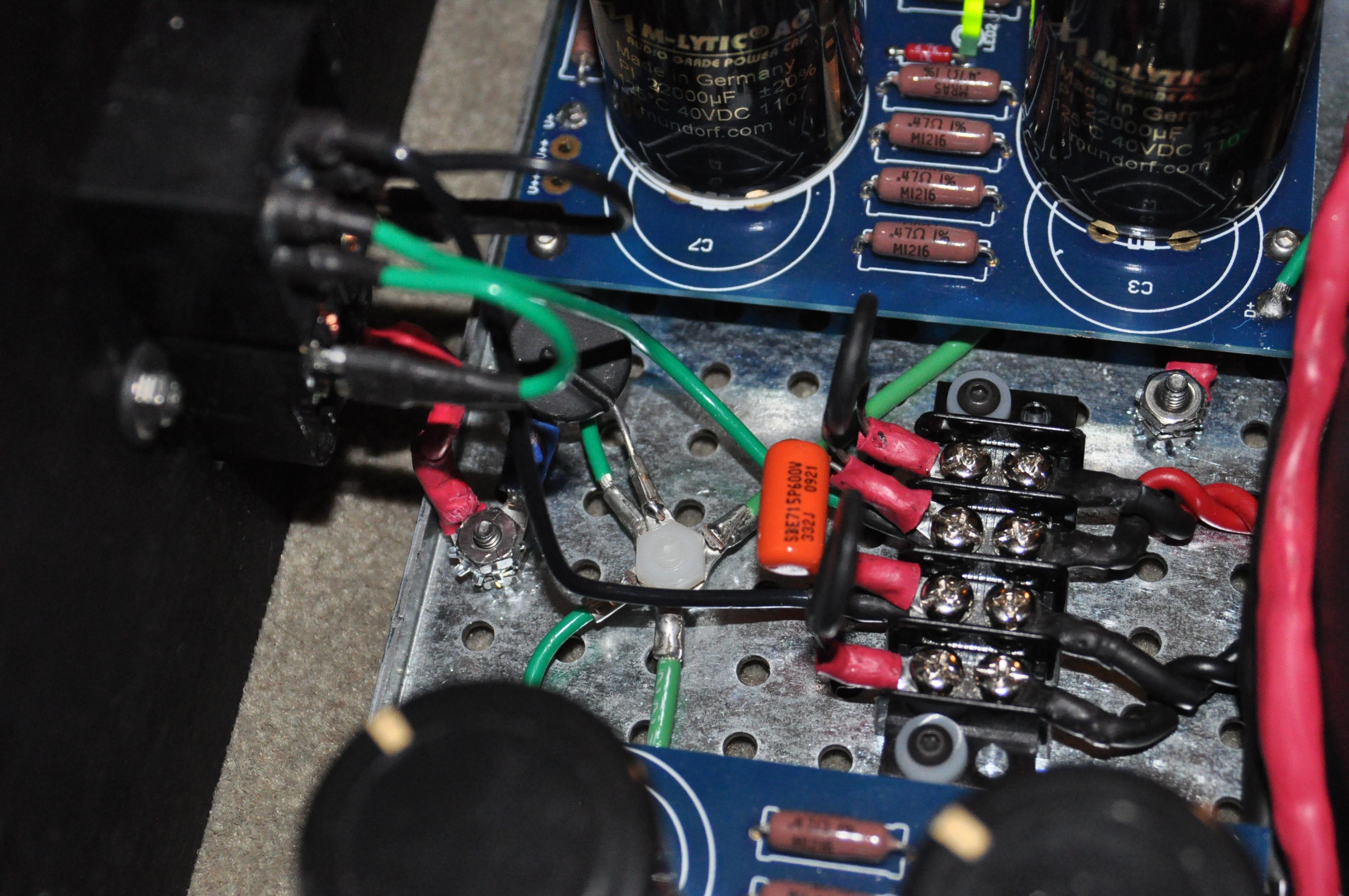

OK so I reconnected everything with a new grounding scheme. I think it might be a tiny bit quieter...
I checked bias and DC offset, everything is in good shape it seems.
The heatsinks are much much hotter to the touch... After ten minutes, the heatsinks were hotter than they had ever been. I will post photos tomorrow and show you guys how I did it.
Overall, I am a bit discouraged and frustrated. Oh yeah, and now there is a volume dependent hum when the squeezebox is turned off and the amp and preamp are plugged in only
Consider trying it with dual bridge feeding single PSU. If it kills the hum, you know you gotta either buy another transformer or a bigger psu to handle both sides. You could run your current dual block in series connection, doubling capacity
I know the dual PSU seems a bit dumb but they each have their own pair of bridge rectifiers. This is not the problem.

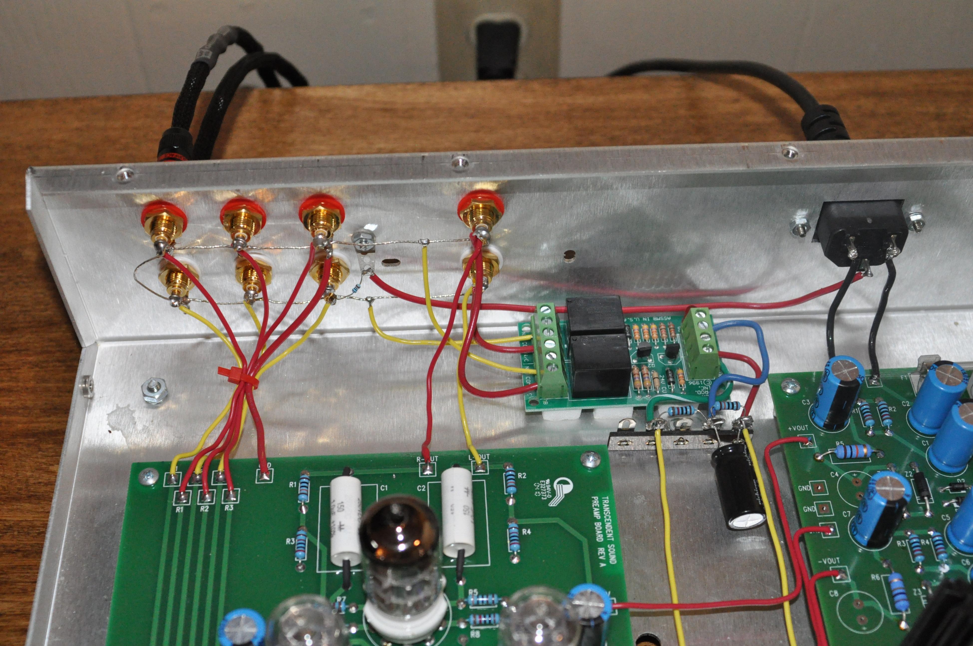

There is a ground loop between my F5 and my Transcendent Sound Grounded Grid Preamplifier. The grounded grid is stock, exactly as I built it from the kit.
When I take the grounded grid preamp out of the equation and feed direct from (Squeezebox Touch => Cambridge Audio DACmagic + => F5) the system is as quiet as a church mouse. Im talking silent! And with 103db sensitive hornspeakers.
The configuration of my F5 is not the problem (other than the ground scheme).
Could I add a ground loop breaker to my grounded grid? I think I am getting close to figuring this out..
haha, yeah that would have been quite helpful in helping me troubleshoot. I have just now removed the preamp from the chain so I didn't know. I never thought to do it... All the work I did on my ground scheme could have been avoided maybe.. But I had to open it up any way. I upgraded R9, R13, R14 to TX2575 resistors and had to change the orientation of the LED's on the amp boards.
Any ideas now that we have narrowed my problem down? I have been reading about ground loops in systems that use unbalanced interconnects.. I know why I am having the problem between my preamp and amp BUT i do not know the remedy.

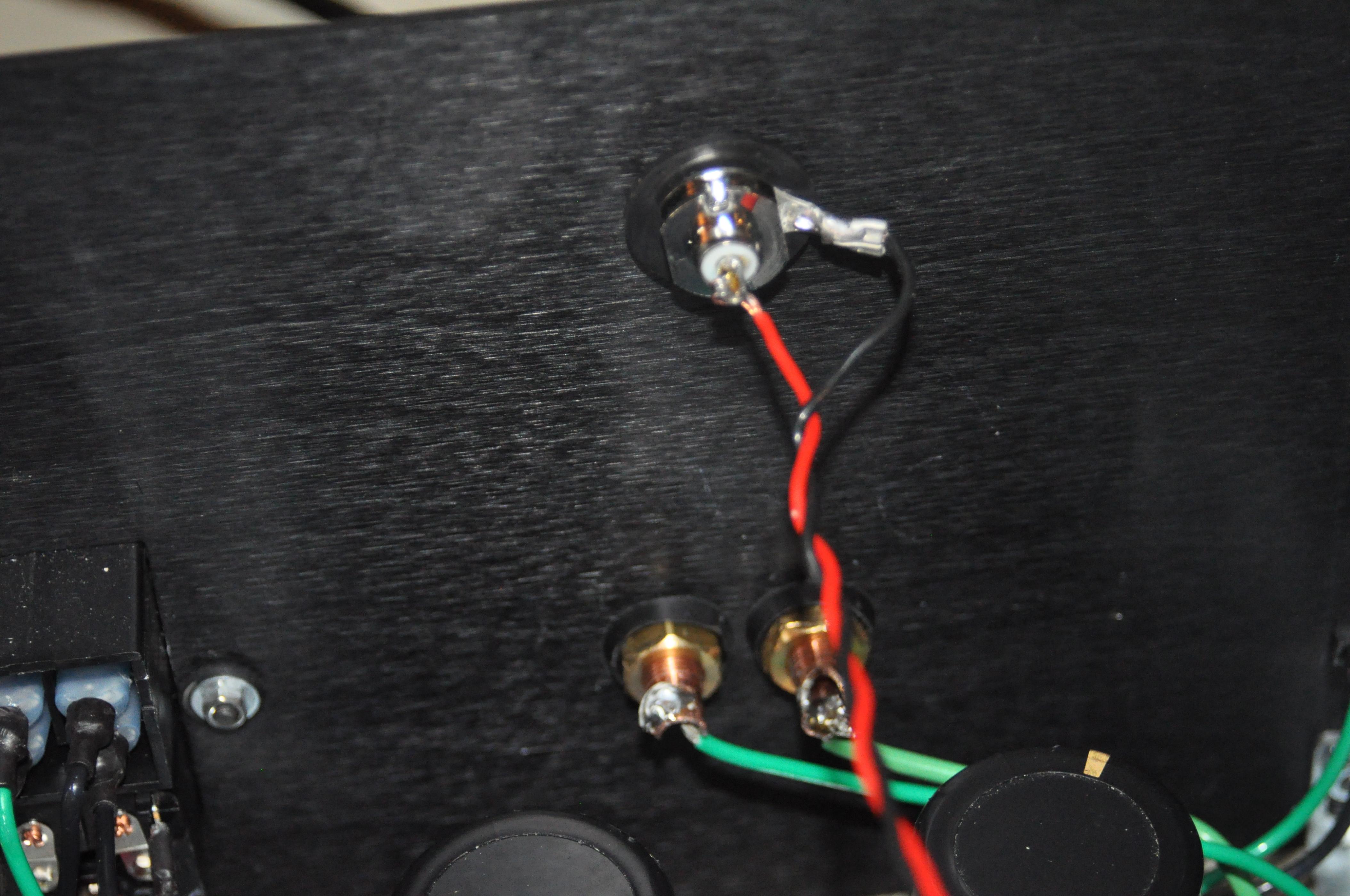

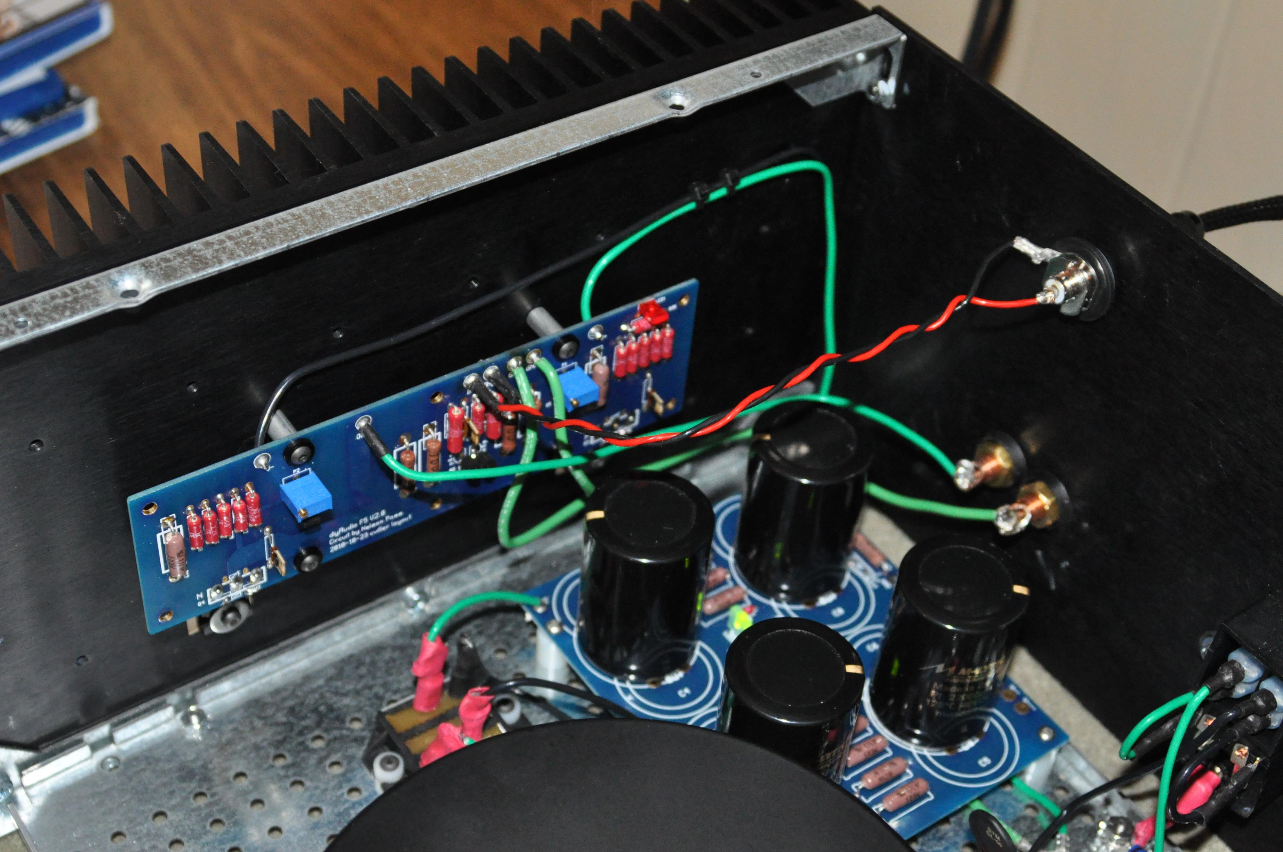

Ok here are some photos of my new isolated Main Audio (Star) Ground. It is isolated from chassis using nylon screw and nuts. All connections are in contact with each other, but are not in contact with the chassis. Main audio ground is connected to Chassis/Safety Earth via CL-60 thermistor.

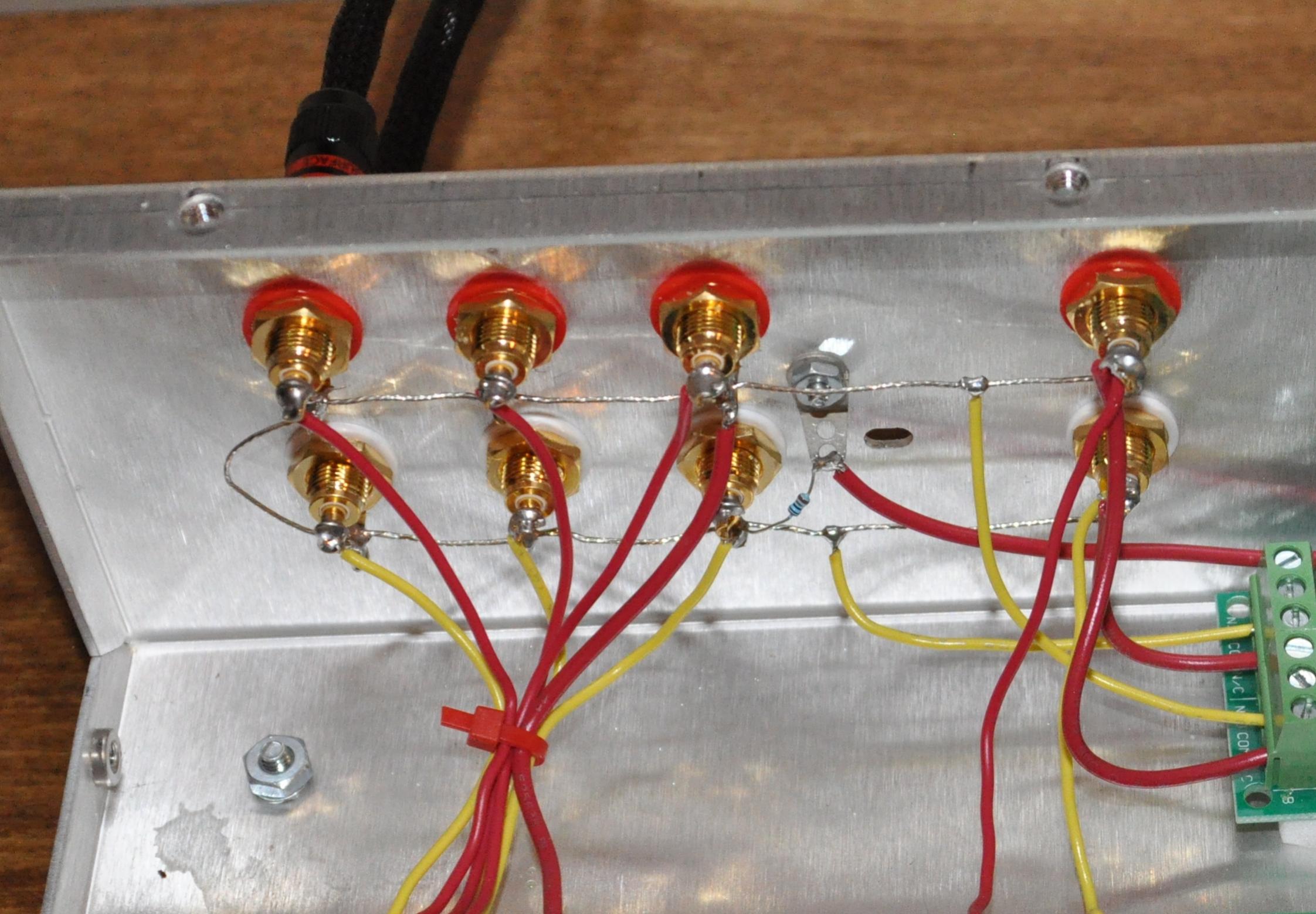

The last two photos are of my grounded grid preamplifier. There is a ground bus wire connecting all the RCA jack grounds. This ground bus is connected to Chassis/Safety Earth via a small 1/4 watt resistor.
