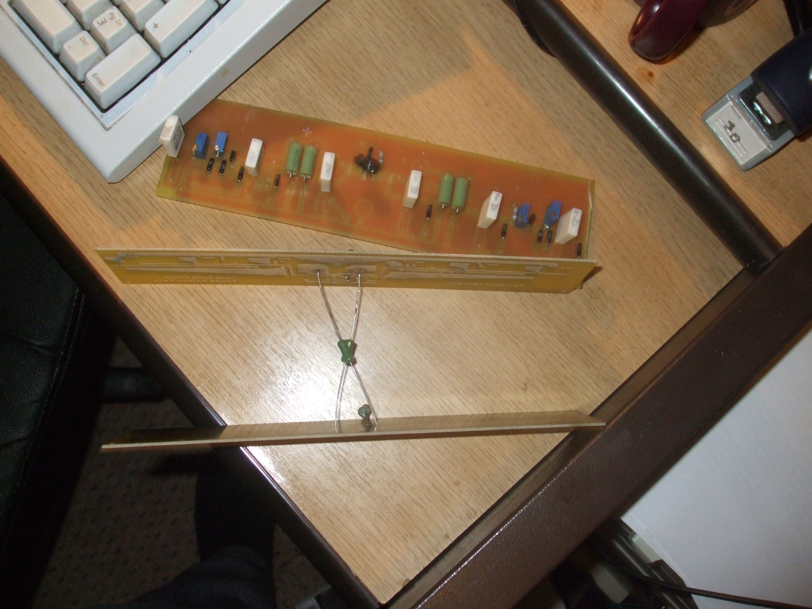

I etched and drilled one channel of the Balanced F5. I hope to stuff the PCB tomorrow. I guess I'll post it in the Balanced thread.

I was soldering the Balanced F5 board last night when I realized it would be a trivial matter to convert my Cascoded board to a Balanced Cascoded F5.
I'm going to try that tonight. According to NP's hints, cascoding helps, and the balanced idea is interesting.
Assuming the transformation goes well, I'll start a new thread for the Balanced Cascoded F5. I'm upset I didn't make this connection faster.
