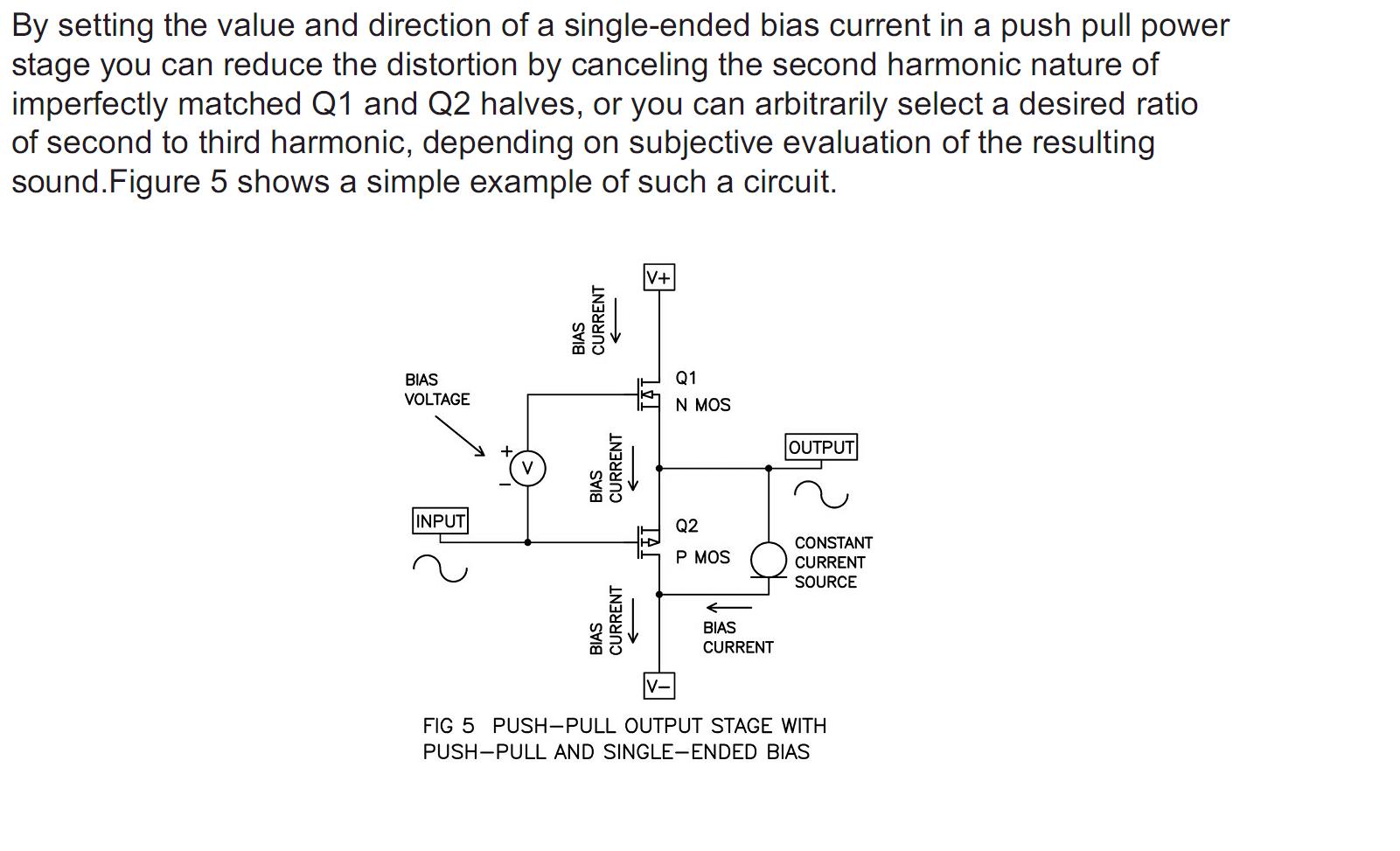

Don't panic yet.
Just because you might need 50W or 100W that does not mean it has to be all in class A (assuming you are using a push-pull design). You could quite happily design for 10W to 20W class A biasing and the rest in class B
A lot of guys who biamp put a 10W to 20W class A amp on the tweeter and then a 100W class B amp on the woofer, knowing that the tweeter uses very little energy and the woofers tend to suck more energy.
The same idea can be applied to a single amp (without biamping) just design a 100W amp but bias it so you get 20W class A and the rest in class B.
Obviously you can't use this approach with a single ended design.
However you could pinch Neslon's idea of putting a current source in parrallel with the p-channel mosfet biased up for a few watts. I think this is probably a better idea than the Aleph current source for most reactive speakers around 83dB to 87dB.
Is there a link to this idea?
I think this is what you want:
http://www.passlabs.com/pdfs/articles/leaving_class_a.pdf
