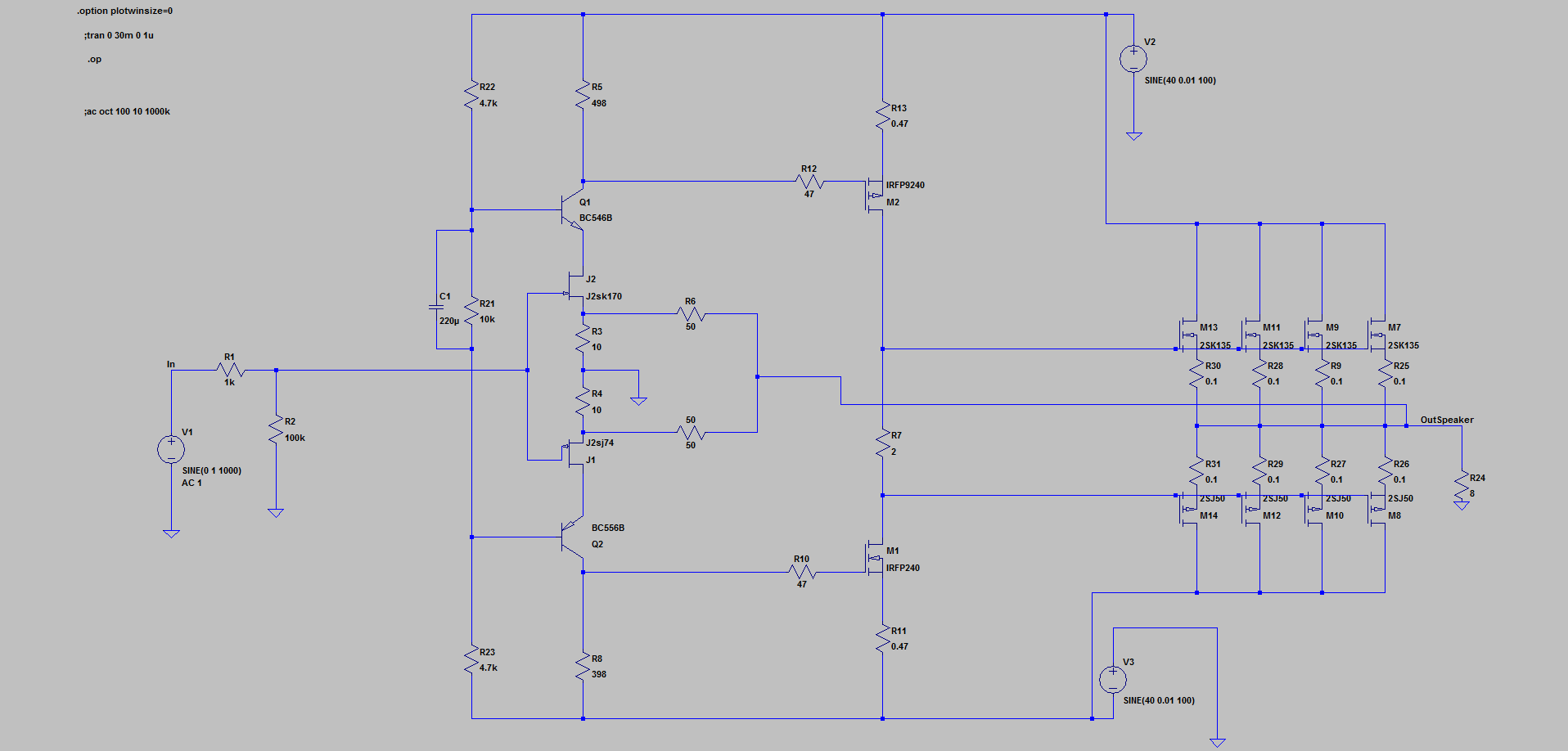

Speaking of different.
How about this one?
Edit: I was too lazy to add the gate resistors
Just maintaining the same voltage gain. IRFP240/9240 has higher transconductance than IRF610/9610
