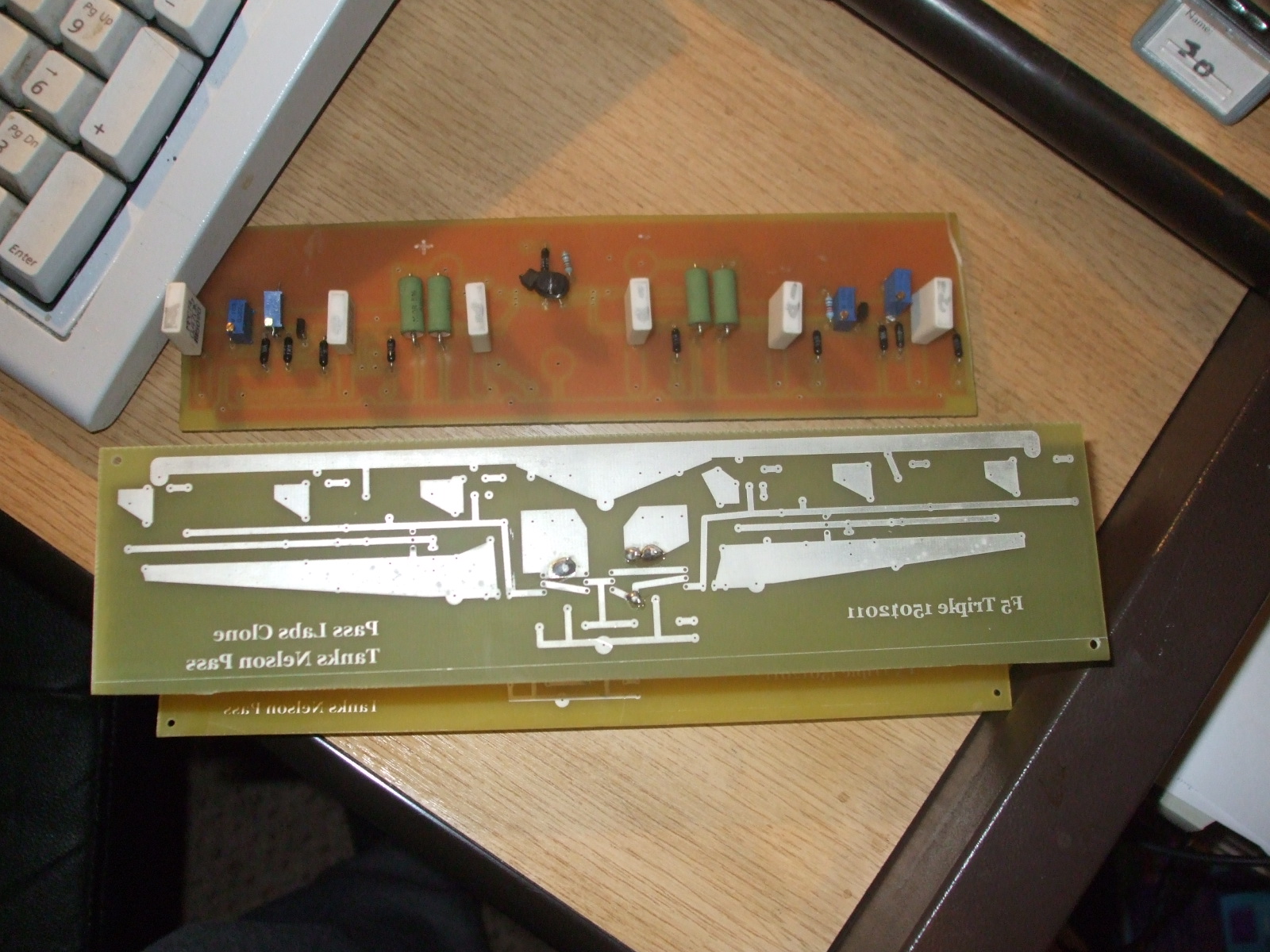

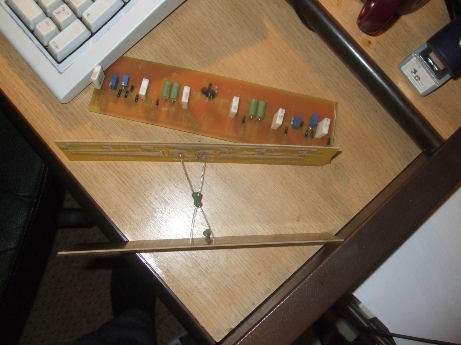

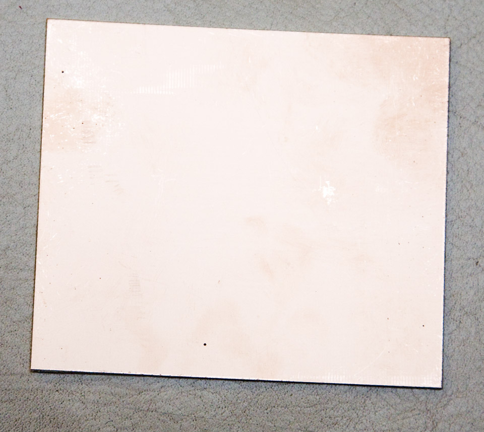

Moving right along - I decided to try a cascoded F5. I have VGS matched IRFP and Toshiba outputs. I hope to try both. As a start, I:
  1. Got out some PCB
  2. Etched a cascoded circuit (based on NPs comments on how to set up a cascoded F5)
  3. Stuffed the boards (Mosfets, caps and trimmers to be added shortly)
Now I'm trying to decide on rail voltage. I have a 22v transformer I'll try for testing (~30V rails), but that doesn't get me any real change from the stock F5. What are the limits for rail voltage folks have encountered in the cascoded F5? I was hoping to use 2 outputs on each side of PP circuit and bias a bit higher than the stock F5.

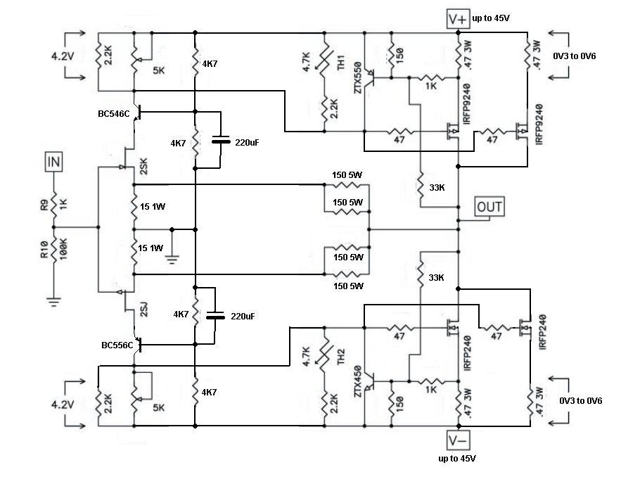

there are at least 4 cascoded F5 schematic posted , all of them pretty much similar .....
dunno - I think that AR2 even tried this one
I didn't , but I can't see why it shouldn't work :rofl:
( full blast voltage version really needs few values/parts endurance confirmation)

I laid out the PCB exactly following your cascode recommendation (attached). I have BC546 and BC556 doing the cascode (awaiting BC550 and BC560 - though I don't know if the noise is an issue) as well as standing in for the Zetex parts. The only change I am making is I am planning to use a 220uF 50V Panasonic electrolytic cap (I don't have a 10uF cap around at the moment).
I'm not sure I follow the "caps to ground" - I have the caps where your diagram suggests. I can change this if I misinterpreted your figure.
Regarding rail voltage - how high do you think sensible?
Thanks again
(Edit) I think I understand - use the bipolars as outputs, right?
The trick in cascoding the F5 would be to use some nice
bipolar devices and see to it that their Bases see a low
impedance at high frequencies. Nice big caps to ground
would do it.

I look at your PCB in post #1 and it's a bit crowded with 150R/3W feedback resistors.
I planned that PCB for 3x150R/2W feedback resistors since I can't buy locally 100R/3W ones.
You can use 2x100R/3W to avoid crowding.

Papa meant on small cascoding bjt's , not on outputs
he gave another important tip - keep strong and firm biasing of them
you already have that in those posted schematics , all over variouss F5 threads
sabath - I meant on wattage of feedback resistors , in case of max PSU voltage

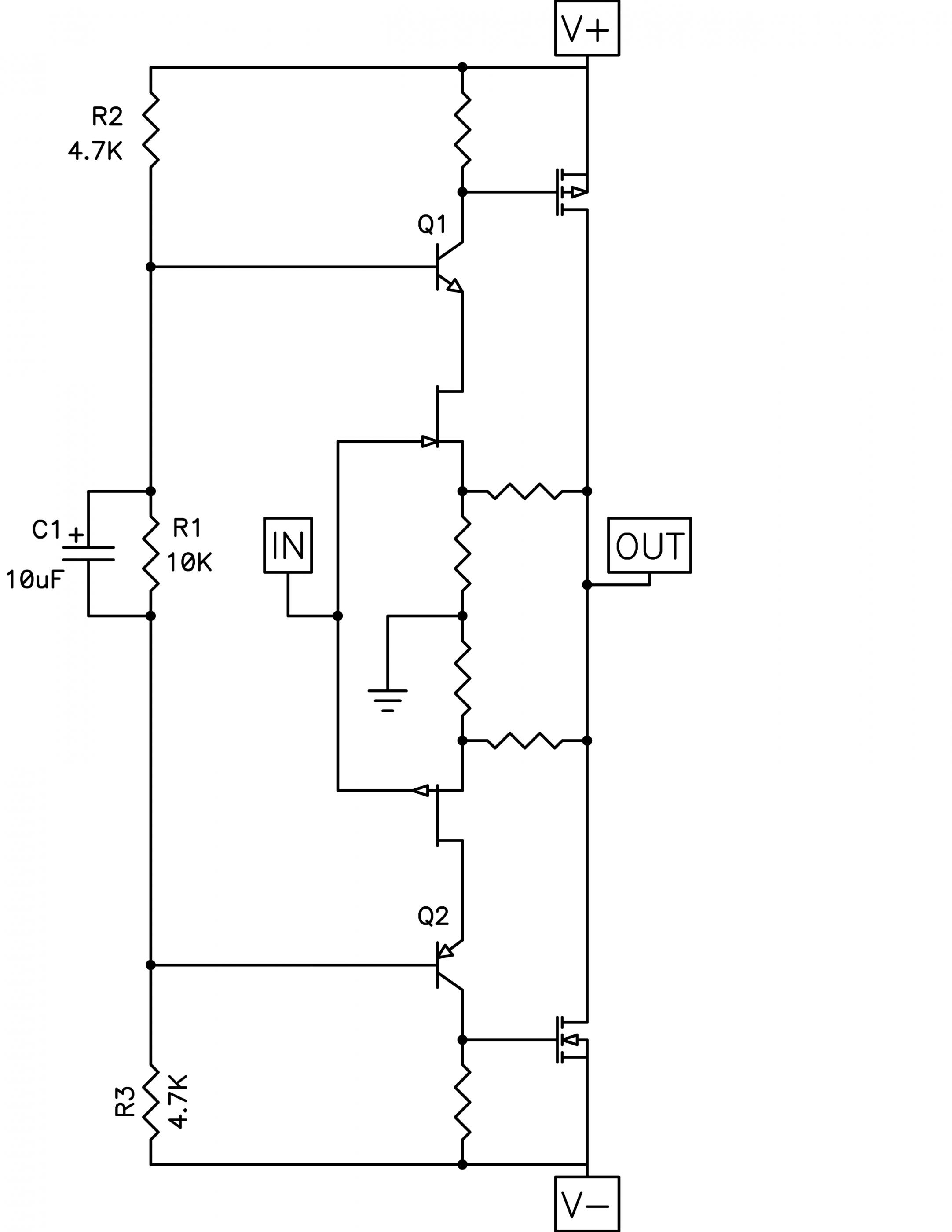

That would be the "fewer parts" edition. The cap from
base to base achieves much the same thing as the base
currents cancel each other.
This is a bandwidth issue, the object being to prevent
the cascodes from degrading the bandwidth due to high
impedances on their bases.
