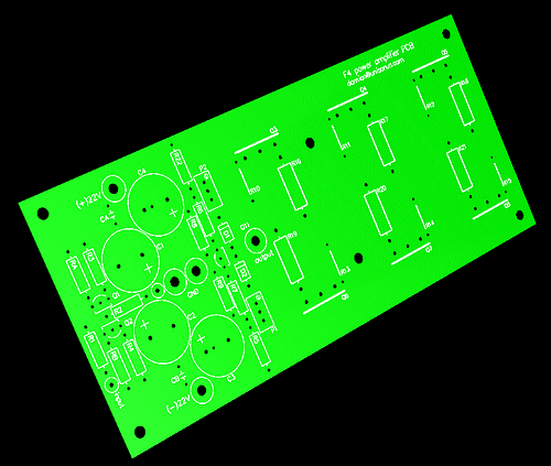

Different point of view on F4 amplifier PCB 😉 Ground connected in only one point.
schematic
PCB top view
PCB bottom view
schematic
PCB top view
PCB bottom view
Nice! 😉
Have you had time to etch and build the thing? Do you have some special heatsinks since you decided to have output fets on both sides?
I'm still waiting for the laminate to arrive - 1 layer pcb seems to be difficult to obtain in Denmark these days... 😕
Not yet, but I will probably order few to make sure, that there are no mistakes (schematic and layout is very easy so there shouldn't be any surprises). I have 200mm high heat-sinks and they will feat just fine 😉
If somebody want to have less problems with matching FETs - IRFP240/IRFP9140 should work better in output stage (I was using such pairs in Dracula amplifier). I added RA,RB and CA, CB components on this PCB but they can be skiped (just place jumper instead of RA and RB).
3D view of this board:

Hey, would it be a big deal if the ZENERS were 6.2v as a sub for the 6.8v in the circuit?
Oh, are Jfets wicked static sensitive?
mpmarino said:
Right.....🙂
you mean crippled 2N4736.......
they're there just for protection- just put what you have in drawer or don't put anything if you are confident that you wouldn't have short circ between headphones during connecting cables to amp
right...🙂
... and thanks.
The ZENERS look to be there to protect the OP FETs, right? Is it not necessary to protect the Jfets? Aren't those little buggers fragile?

When we adjust bias voltage, e.g. TL431, we could make a
mistake by accident. If the bias voltage is too high,
the power mosfets would suffer from excessive current.
If so, when we have no spare parts, hmm . . .
Meanwhile, the input jfets are formed with self bias. As long as
the rail voltages are under control, the jfets are safe. In my
opinion, the probability for us to use wrong rail voltages are
ignorably low.
