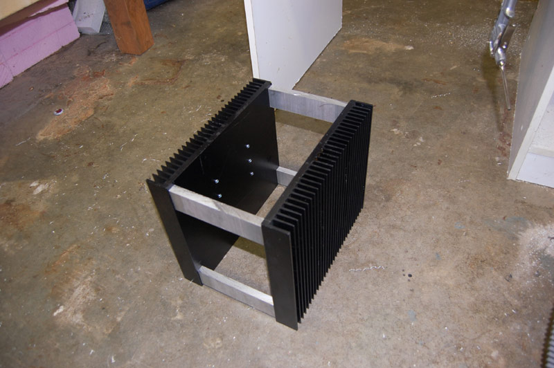

Thought i would post a picture of my chassis for my F4.

DocLorren said:
Jason,
Are those sinks made from one piece? On the pic I thought it could also be two smaller sinks bolted together with a black-colored plate on the inside.
If yes, please post a link for some serious sink shopping. Thx.
It is Actually 2 heat sinks, one per side, if i remember it is 12" x 11" piece. They are heavy :)
