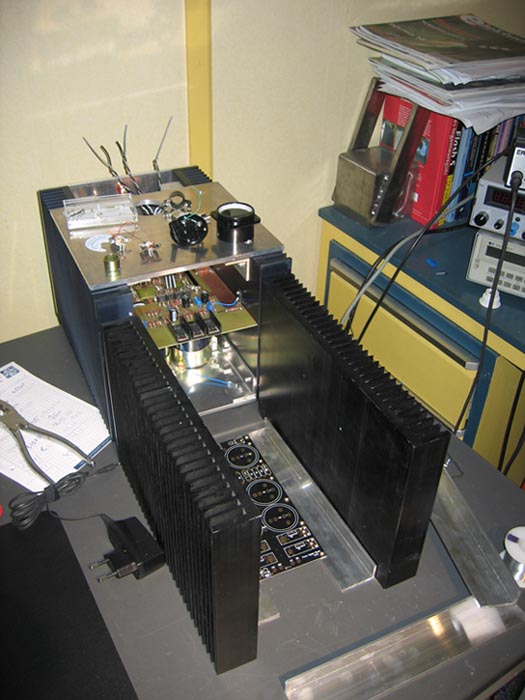

Today i received my secondhand heatsinks, the sk56 from fischer at about 200mm height they will do 0,3 C/W. I also using these on my aleph 5's. I planning to build first one stereo F4 and later on i will build an other one so I can use them balanced.
I'm currently searching for a nice toroid 300VA or something like that.
