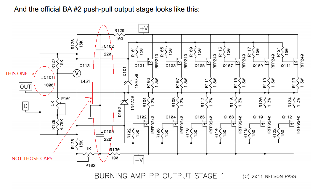

I mean the Cin, not the reservoir caps.
Attached is the BA pushpull output stage, the same design as F4 but without the buffer.
If the input is 5K, why 440u or 1Ku at Cin?

input node is just conveniently connected between these two caps (they having a role which I told you); it can be just one cap, but then you must use dedicated coupling cap - see M2 for example of that
2 caps in BA are "just" C part of additional RC filtering of rails

Thank you Zenmod, understood.
I think they (or it) have to be of very good quality.
I don't like very much bipolar caps at the input, but this is a different case.
