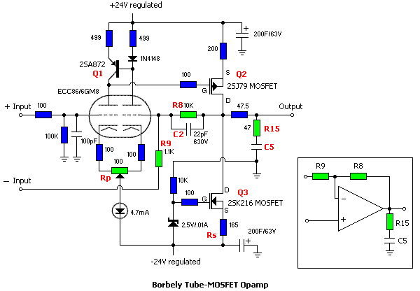

juma said:In that case the input JFET pair could be left out of the circuit.
Without the JFET input it would look like a PP output stage for a hybrid tube-MOSFET power amp, such as the one on the picture.
I've tested that output stage, connected to a pre-amp before the tube front end was hooked up.

flg said:You mean that bootstrapped TL refrence bissiness???
There's a bootstrap in the amplifier?
