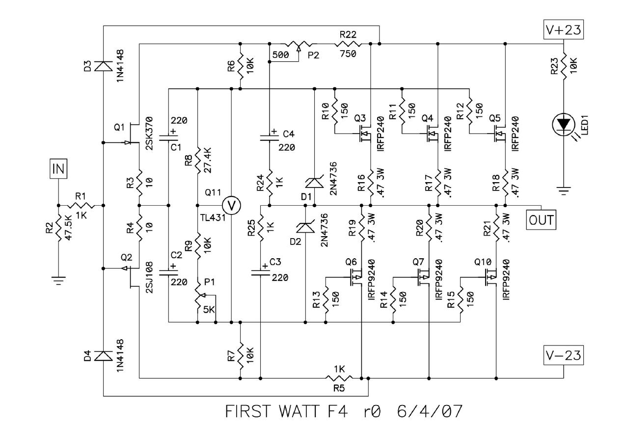

OK Folks
Now I've got the revised 2007 version of the F4 circuit .
I can see some changes, and some 'issues' if I try to build the 2006 circuit ( for which I have all components ) on Peter's PCBs . There are changes involving how C3 and C4 connect via R24 and R25 onto the 0V which are not the same on the earlier circuit . Maybe if Peter is out there he can comment .
Mark
Ok
Now starting to build my F4
Does anyone have the circuit that Peter Daniels used as ref. for F4 signal PCBs ?
I used this circuit:
Thanks Peter I just got that circuit earlier and have been looking at it .
I'm getting a sinking feeling that I won't be able to build the earlier circuit on these PCBs .
I'll have to start ripping stuff out of the ( beautifully designed and made ! ) PCBs ...
Think I'll go back to the speaker project for a couple of weeks .
Mark

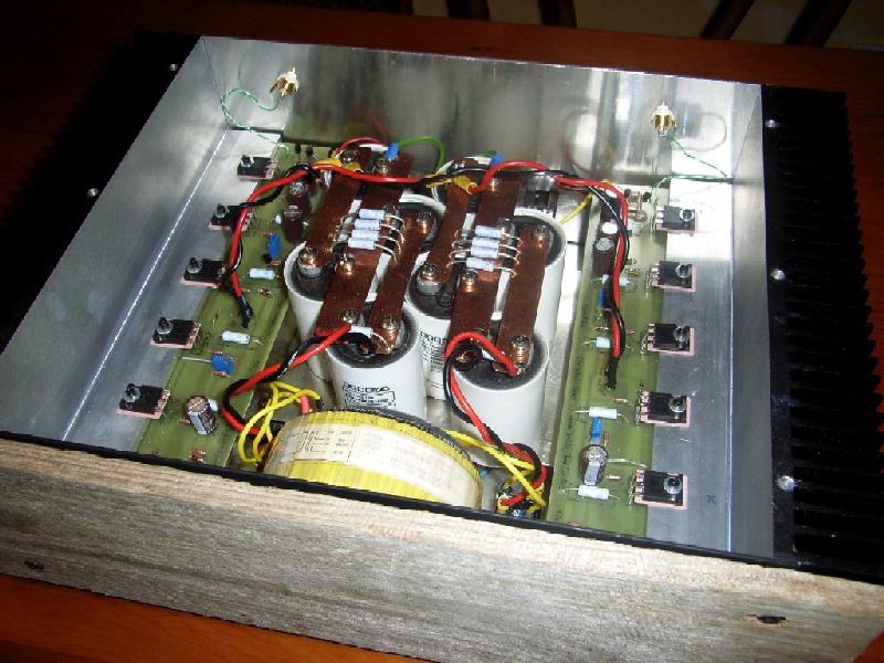

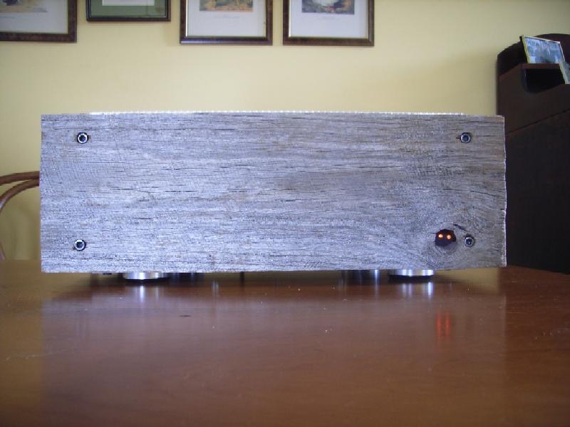

Finally Finished
My first real DIY audio project!
Thanks to cviller for help with the boards and jacco and steenoe for advice on the big RIFA’s.
And, of course, to Nelson – from one ’51 baby to another, thank you for providing the reason and means for an old dog to start learning some new tricks.
I've tried to finish the amp in the Aussie vernacular style – still looking for the right bit of weathered corrugated iron to put on top. 😀
Pumpkin is balanced, well it could be used single ended but kid of a shame. Finding a single ended amp with enough gain may be an issue. On the other hand I am driving my F4 with an Impass (Balanced) while the pumpkin get its microprocessor upgrade. I am not sure the one I will keep. The Pumpkin has a little more detail but the Impass is a little more laid back. Both excellent preamps'.
P.S. just noticed led eyes peeking out of knot hole - cool
