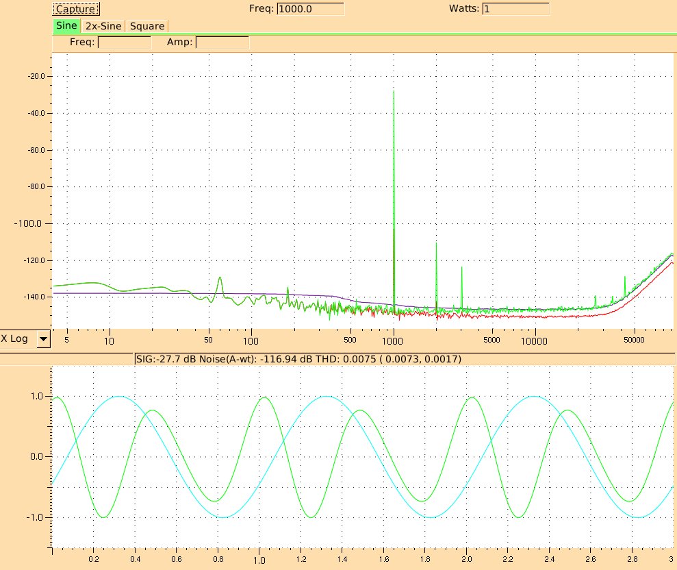

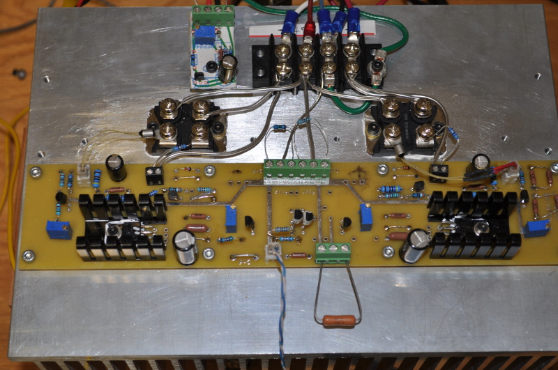

I finally started bench testing.
The initial OS bias circuits caused the output fet bias current to increase from 1.5A at 22C to 1.7A at 53C. A minor change to a resistor in each bias circuit fixed that, and the bias variation is now less than 40mA.

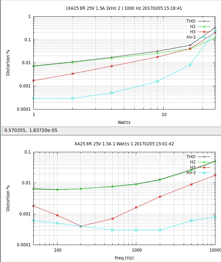

At this point the only tuning has been to tame the H2 level with a 510K resistor on the -rail cascode feedback. I lot of tuning is still required as can be seen in the power and frequency sweeps shown below. The high distortion levels at 25W are probably due to limitations of my bench power supplies. I haven't yet built the final power supply.

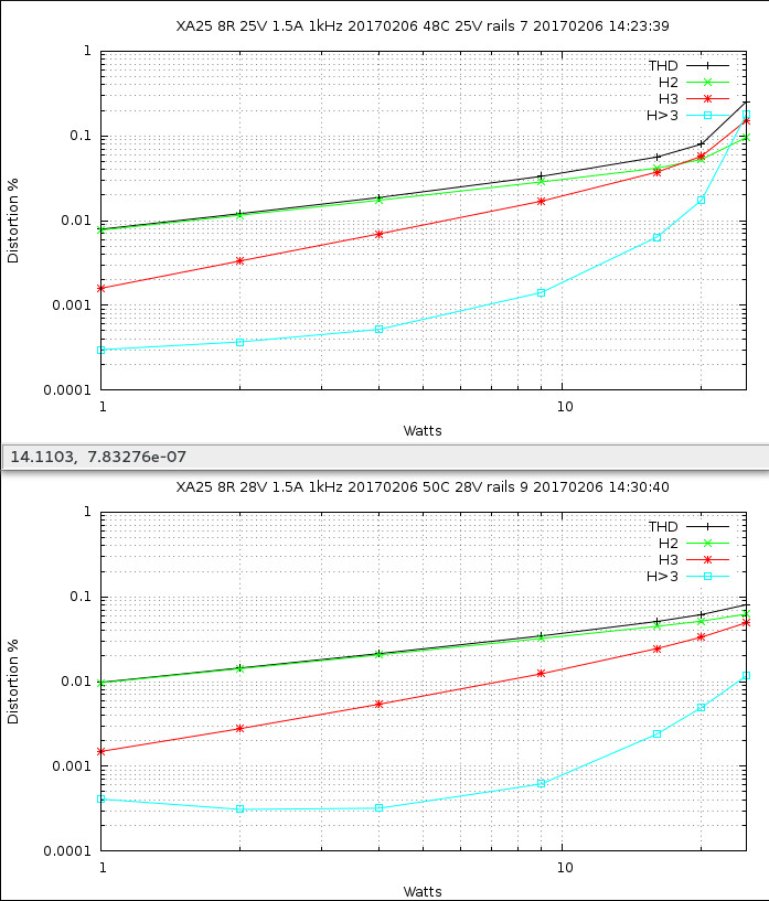

My measurements were made with (slightly less than) 25V rails. I made measurements with 28V rails and the 25Watt distortion measurements fit smoothly with the curves from the lower wattage measurements.
In retrospect, the high distortion levels are due the Vds being less than 7V-8V and the high Ciss and Crrs levels at low Vds values.
The distortion vs. Watts graphs in the Pass Labs XA25 Owners Manual certainly suggests that rail voltages are high enough to stay out of that Vds region, BUT, those plots do not specify the test frequency. If the test frequency is low enough, then Ciss and Crss have a smaller role in the distortion.

For comparison here are distortion vs. watts sweeps for 25V rails and 28V rails.
From 20w and up there is clear improvement.
2nd harmonic you can tweak to low value, but 3rd is higher then original, IMHO more feedback and/or more bias is needed. (with so low thd original probably have nuled 2nd)
