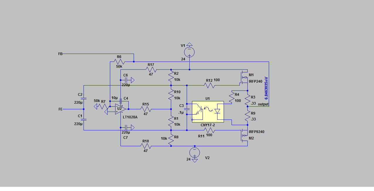

Generg, does the bandwidth go up if you lower the toshiba gate resistor values on that circuit? I just tried a simulation of a slightly modified version of Nelsons headphone opto bias circuit with this amp. I broke a rule by using resistors on the output transistors but it sets both the bias current and offset. When the toshiba gate resistors are at 1000 ohms the bandwidth is 330khz and with 100 ohms it is at 1Mhz.

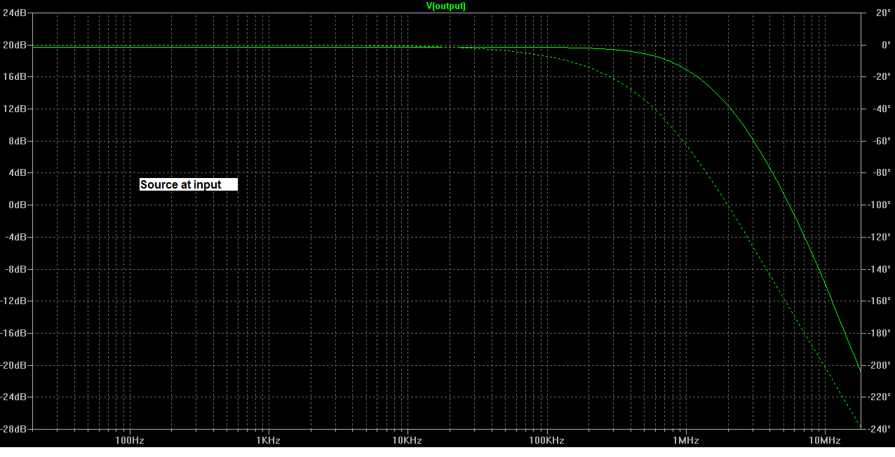

Did I do it right? for the first data I set the AC of the input source AC=1
magvout: mag(v(out))=(20.0676dB,0°) at 1000
f3db: mag(v(out))=magvout/sqrt(2) AT 210135
phase_margin: atan(im(v(out))/re(v(out)))=(33.7472dB,0°) at 1.75667e+06
gain_margin: -20*log10(mag(v(out)))=(26.3923dB,0°) at 1.04701e+07

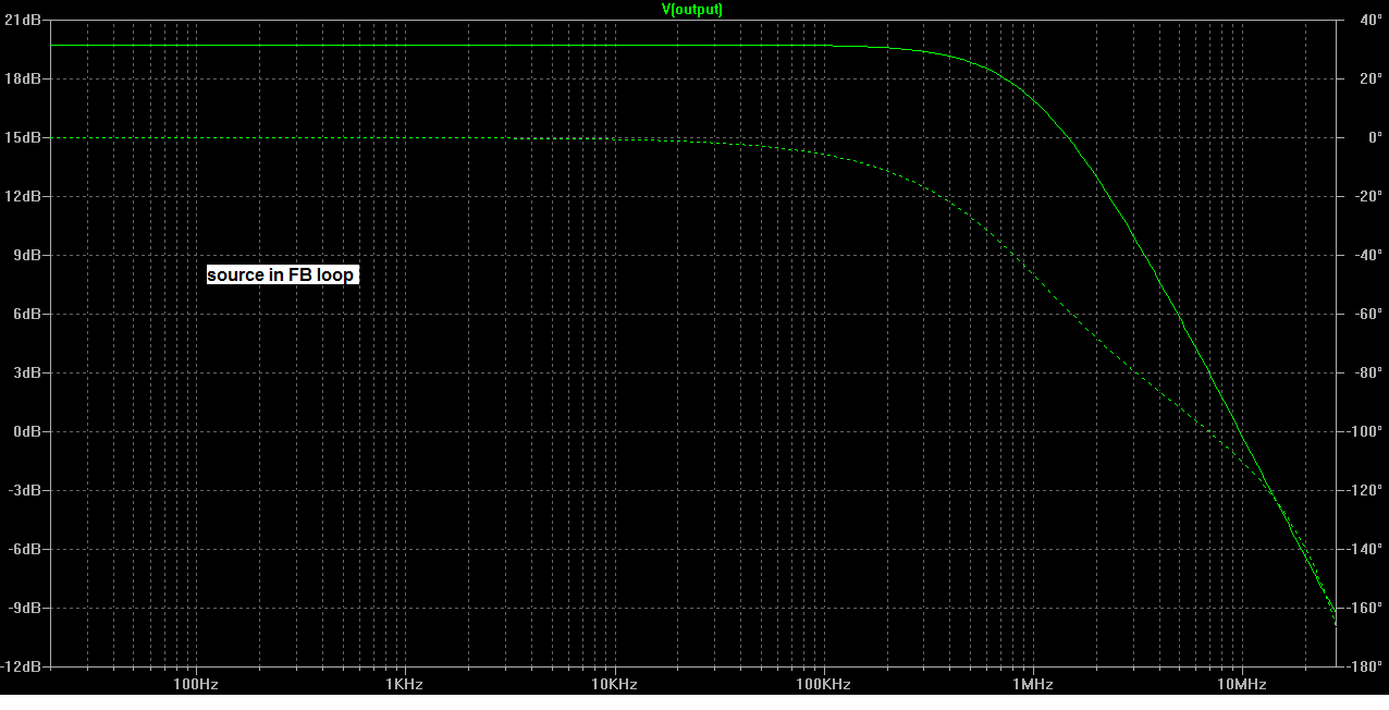

and of this data I deactivated the input source and activated the feedback source with AC=1
magvout: mag(v(out))=(20.0771dB,0°) at 1000
f3db: mag(v(out))=magvout/sqrt(2) AT 209245
phase_margin: atan(im(v(out))/re(v(out)))=(35.4522dB,0°) at 1.81029e+06
gain_margin: -20*log10(mag(v(out)))=(27.3892dB,0°) at 1.42114e+07

Ok then it is only my circuit that is acting that way with the bias/offset circuit attached to it. Here is the circuit but with the wrong mosfets at the output. I would like to know why it acts that way.
Both sets of measurements look plausible, but I am surprised that the -3dB frequency is so high with the input and actually lower for the feedback loop. Is this with a CFA input stage or something else? In my simulations with a jfet gate stopper of 33K is get -3dB at around 105kHz from the input, and about 800kHz for the feedback loop.
If you put the circuit above on the second stage of a three stage amp to drive another source follower you could fun the feedback for the offset from the final output stage back to the op amp. Then it should keep the output offset at zero and the second stage bias constant. You would need to have the voltage gain in the first stage though.
In my other posts I was talking about the gate resistors on the mosfets that changes the frequency response.
Lynn, I used the same front end as you did.
Sorry, I was addressing Generg's measurements.
Indeed Lynn the first data had considerable CFB, now with out only global FB
input AC
magvout: mag(v(out))=(21.1412dB,0°) at 1000
f3db: mag(v(out))=magvout/sqrt(2) AT 188336
phase_margin: atan(im(v(out))/re(v(out)))=(33.6045dB,0°) at 1.76034e+06
gain_margin: -20*log10(mag(v(out)))=(26.3862dB,0°) at 1.04495e+07
feedback loop AC
magvout: mag(v(out))=(21.1507dB,0°) at 1000
f3db: mag(v(out))=magvout/sqrt(2) AT 187676
phase_margin: atan(im(v(out))/re(v(out)))=(35.353dB,0°) at 1.81407e+06
gain_margin: -20*log10(mag(v(out)))=(27.3796dB,0°) at 1.42083e+07
both -3dB are very similar
