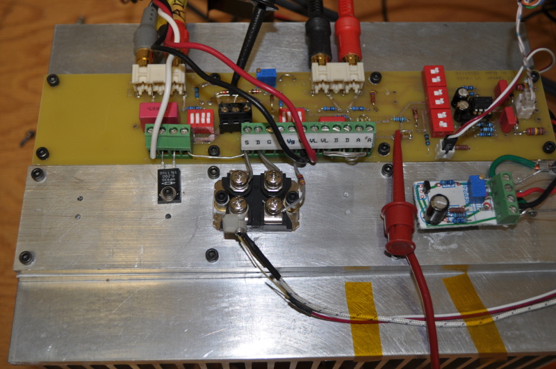

Just thinking about the thermistor, we could possibly bolt that thing straight into the extra source pin for almost lag free thermal tracking, just haven't decided whether the thermal lag is desirable or not.
I might try it both ways.

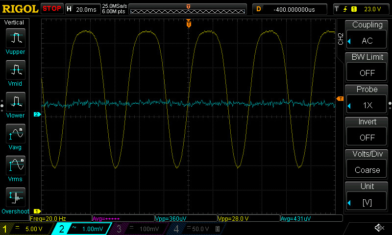

Do we want the thermistor to perfectly thermally track the AC signal (will the biasing circuit operate linearly over a wide range of AC current when the thermistor is added) or do we want the thermistor to be blind to the AC signal? Do we want the thermistor to have enough thermal lag that it isn't affected by the AC signal?
Just thoughts.
This is why I tend to like the cave man approach. Less for my brain to think about. Hahahaha
The thermal time constant of the thermistor and the mass FET case and heatsink should be quite long compared to 20Hz. I can do a test right now: a 20Hz signal, approximately 0A to 3A into an 8R load with Vds at 24V quiescent, and look for any AC signal on the thermistor output.
Here is the "thermistor thermal modulation test". The R25=10K thermistor is mounted to the unused source terminal as shown in post #223. One end is connected to ground, the other end thru a 20K resistor to a clean power supply at +15V. The fet is driving an 8R load connected to +36V. The CH1 trace shows the voltage on the FET Drain pin. The current ranges from about 0A to over 3A. The CH2 trace shows the AC voltage across the thermistor. Nothing detectable. The DC voltage is around 2V.

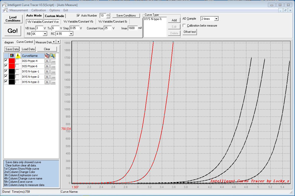

I installed the 48NP60 and the 40P50P instead of the old puck ones.
First I was afraid that I could get a bit difficult because the Vgs threshold of the new N and P pucks were very different and different from the values Nelson showed in the BAF2016 talk.
Look at the picture...I could not order more... no money end of the year as always....🙄
But all went fine, I could adjust both channels without difficulties to 1.5A.

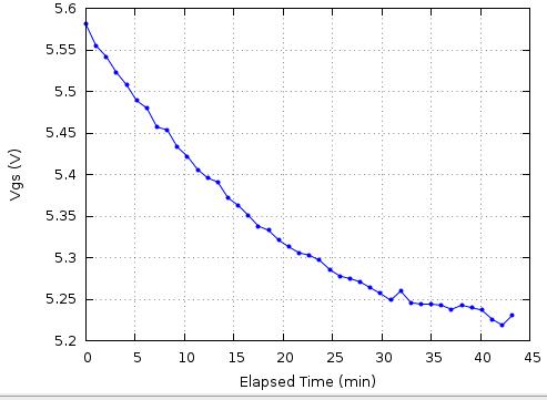

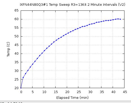

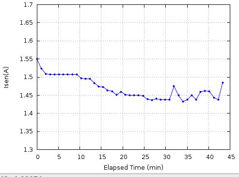

Here are some results from a quasi-constant bias current circuit. The plots show Temperature vs. time, Isen (bias current) vs. time, and Vgs vs. Temperature. The heatsink started cold at around 20C and was heated by the FET unser test, and an additional FET dissipating about 100W additional. The bias current drops about 3% from 25C to 50C. The slope of the Vgs vs. Temperature curve is very sensitive to the resistor values in network around the TL431.
