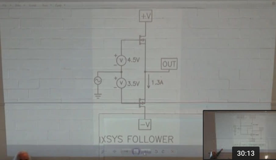

Because lhquam told us to study the speech of Nelson at BAF2016 more arduously.....
I did it again. A thing that I already remarked already some time ago, got my attention again.
The Vgs values he shows for the P and N pucks at 1.3A and zero offset!
He has a fairly big difference between the Vgs values.
P channel 3.5V and N Channel 4.5V. That is a difference I never had with my parts. My difference was always much smaller around a half Volt. Look at my last picture some postings ago.
Is the big difference an expression of big difference in transconductance, so the N type needs much more Vgs to get the 1.3A, means lower transconductance?
But this difference could also be a result of a different Vgsthreshold maybe from 3-5V.

Don't forget Vgs threshold may also be different brother (Edit: you actually already said that. hahaha). So not necessarily indicating differences in tranconductance, but you could go hunting all the data sheets, to see what matches that.
I honestly wouldn't worry too much, just use whatever tricks you need to get the sound you want.

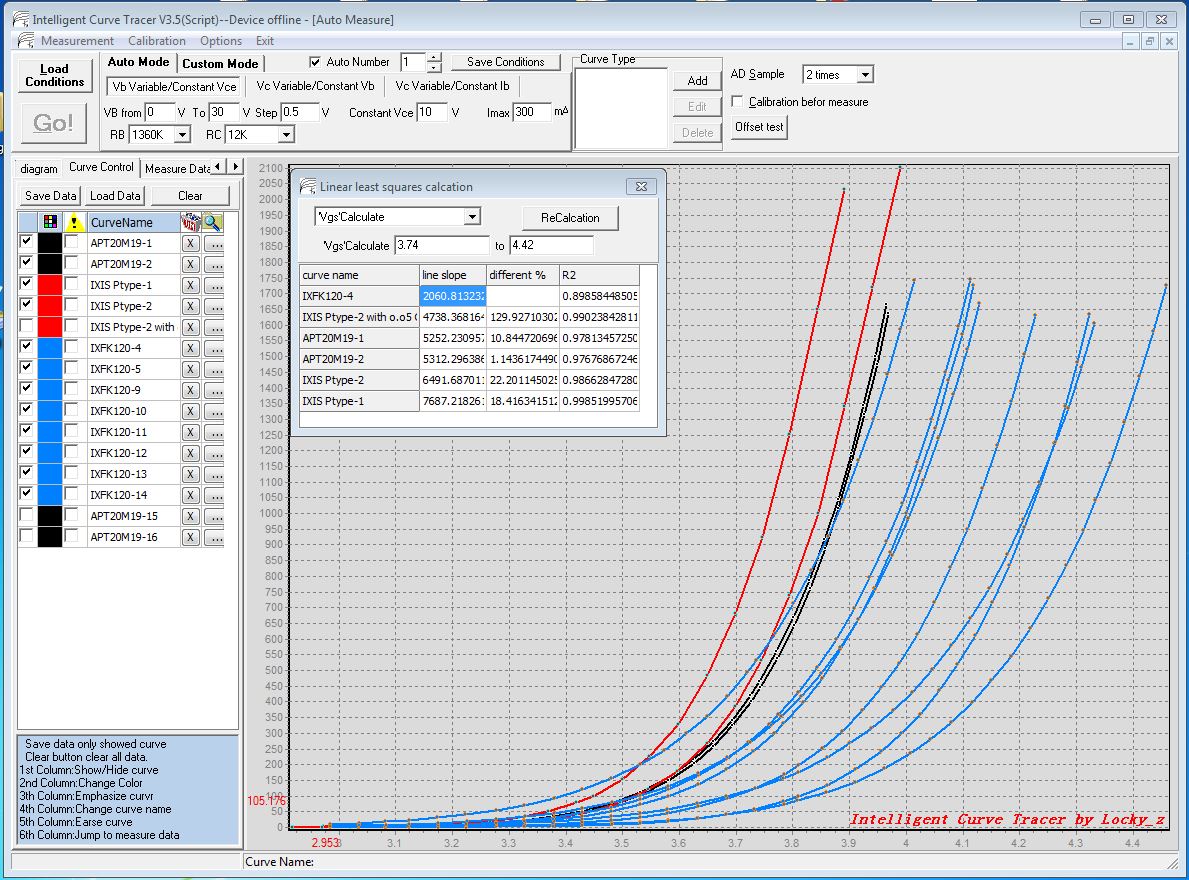

Indeed I looked at my fund of IXYS and I found some N parts that have this high Vgs at 1.3A. Look at the most right blue line. But you see most blue ones are more left.
It is the IXFK120N20, unfortunatly I owe only the K Version with TO-264, they were cheaper for thesting purposes.
So I suppose the IXFN120N20 with SOT-227 would have the same range, but how many I have to buy to get the one with the 4.5V? Could get expensive, and it is not secure if this is really the bill......

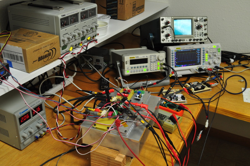

I promise I built it. Hahaha
The table!
